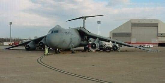

This one came up today from one of the techs have a guess what caused it to get into that state
Problem while fueling...

Yes while fueling after sealing the tanks and forgetting to open the vent vales.
Blew the central tank in the wing box
Seems like a case for a pressure relief valve somewhere, maybe near the pump[ponder]
Vents are pretty good PRVs... if they're open.
They physically block them I believe doing the tank maint stuff.
The fuel Bowsers pump at about 3 bar normally. Min pressure of the fuelling system to work is is 2 bar.
second thoughts, near the connection to the aircraft tank, lest the tank put up too much resistance... but that would require a fuel return hose, dunno if that is already there.
The is nothing the bowser either pumps or suck fuel out.
At the end of each wing there is an expansion and a surge tank which is vented to the outside via a ram jet vent. Which gives the tanks a positive differential in flights.
If anything goes wrong with fueling you end up with a jet1fall at the wing tips. You always know the new refuelers because they park under the vent.
