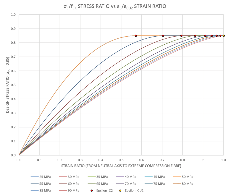

Couple of questions about how people deal with the EC2 parabolic-rectangular (or any other non rectangular) compression block in practice/practical design, especially when dealing with non-rectangular sections or bi-axial bending where the width of the block is changing with respect to depth from the extreme compression fibre:-
For a rectangular section (i.e. beam) with flexure about one axes only, its quite easy to resolve the parabolic distribution to an equivalent rectangular stress block for the purposes of calculating the ultimate capacity of a section, i.e. same area and centroid via integrating appropriately the 3.17 equation in EC2.
This only works for rectangular sections with one principle axes moment. For anything non rectangular (say a circular section), or bi-axial bending in a rectangular section (i.e. column), do people typically just use the rectangular stress block from EC2 and apply the 10% reduction to η (the reduction in f_ck) noted in clause 3.1.7(3) and not 'go there' with the parabolic curve as it all gets too hard.
If doing things by hand I'd simply do it this way as its close enough for ultimate capacity, but for spreadsheets you can obviously go to the effort of working things out using the parabolic or bi-linear relationship and apply the EC2 parabolic distribution to the non-rectangular section and work out the area and centroid (presumably need to integrate the 3.17 relationship over the curve and the section shape (i.e. find the volume and centroid of the resulting 3D stress block in the section).
I can't imagine this is too hard, though my integrating skills were put to the test just doing the 2D problem for a rectangular section, and have never attempted finding the centroid and volume of a 3D shape like this!
So how do people deal with this in practice, we are told these more advanced curves are better/more accurate, etc, etc... but is it all just too hard to do in practical design unless you are using some software that already does these things for you?
Also is anyone aware of any generalised solutions for the volume and centroid of the parabolic-rectangular stress block for 1) circular or 2) rectangular sections with biaxial actions?

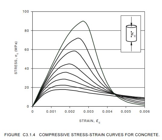

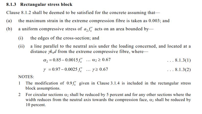

Rectangular stress block from AS3600-2018.

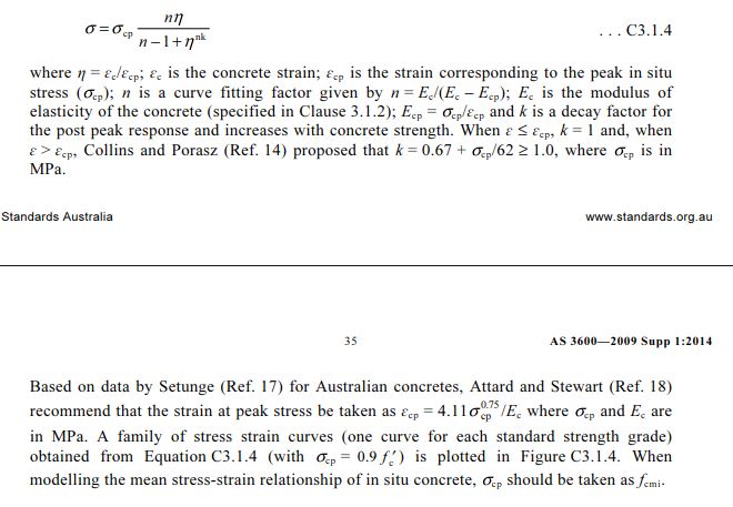

Curve from 2014 commentary on AS3600-2009.
steveh49, looking at your plots again, your EC2 curve should also stop at the max strain for a given concrete strength (instead of carrying on horizontal to 0.0035), 80MPa curve should stop at εcu2 = 0.0026 for example. Does the AS commentary one might also have some limiting strain like EC2 that is lower than the 0.0035 plotted (guessing whoever is kind enough to post the AS commentary curves will clarify that aspect for me Thanks steveh for posting as I was writing this reply!)?
Many different ways to express the same thing on the assumption of a constant neutral axes depth for illustration purposes, first one probably best shows whats going on conceptually with increasing concrete strength and the stress distribution. Once I look at some real sections I'll get a feel for the variation in neutral axis depth and can plot the true design stress distribution for varying concrete grades for a given section (i.e. 0,0 point will likely change based on strength):-

Looking at the Australian commentary curve, I'd be hesitant to use it for anything but Australian concrete as it's implied as being quite specific to Australian concretes based on some of the contributing factors. Still, interesting to compare at least.

AS3600 requires that the compression reinforcement strain not exceed 0.003 (clause 8.1.2).

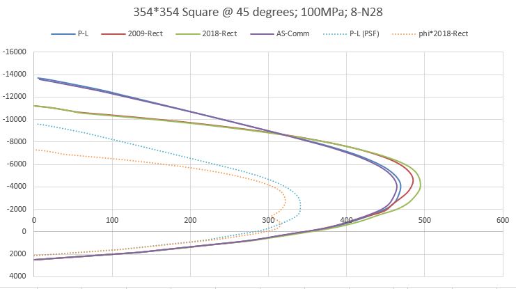

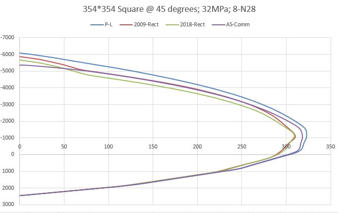

Hasty modification of my spreadsheet to include rectangular stress blocks. Hopefully no errors introduced while doing that. The details are:
[ul]
[li]354 x 354mm square section, rotated 45 degrees (aka equal biaxial moment that Rapt mentioned earlier)[/li]
[li]8-N28 bars (one each corner and one middle of each side)[/li]
[li]100 MPa (first image) or 32 MPa concrete.[/li]
[li]Peak stress is 0.9*f'c for the P-L and AS-Comm curves per AS3600 requirement.[/li]
[li]10% reduction for cross-section getting narrower toward the compression edge hasn't been applied.[/li]
[/ul]
The odd dimensions and heavy reinforcement are because I forgot I need to enter the diagonal dimension rather than side dimension for this 'diamond' cross section. I meant to do a 500*500mm section. 3.9% reinforcement is just under the limit so 354mm is a valid cross-section still.

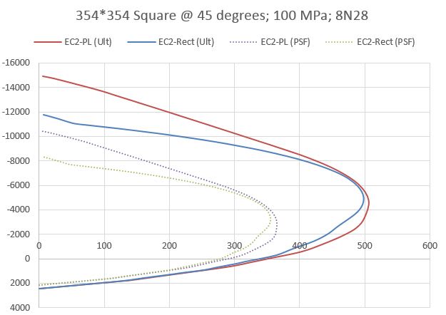

For 100MPa concrete, the ultimate interaction curves for rectangular stress block go outside the P-L curve. AS3600's safety factor (phi) is however more conservative than EC2's partial safety factors (PSF) in this case, so the rectangular design curve falls inside and is more conservative than EC2 even without the 10% reduction due to cross-section narrowing. I think also that this PSF curve is a little conservative compared to an EC2 design as I've included the maximum 0.9*f'c requirement from AS3600 that I don't think EC2 requires. (?)
For 32MPa concrete, the ultimate curves for rectangular stress block are inside the P-L curve. I didn't bother doing the phi*ultimate and partial safety factor curves as I expect that a similar result to 100MPa would be the result (ie rectangular stress block design to AS3600 gives lower capacity than EC2 P-L design).

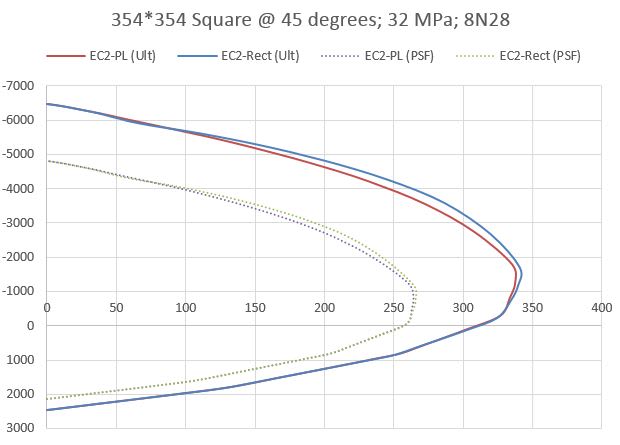

Here's what I should have done first, but I was selfishly wanting to add Australian requirements to my spreadsheet.
These graphs are pure EC2 (to the best of my knowledge - I don't use it for design), except the 10% reduction for narrowing cross-section isn't used for the rectangular case. For the parabolic-linear curves, the peak stress is taken as fck.
For the UK at least, the alpha_cc factor is 0.85 in the national annex, I guess this is comparable to the 0.9 reduction in AS3600 to f'c. F_cd = alpha_cc*f_ck, unsure how other European national annexes treat this factor, whether they accept the EC2 default of 1.0, or call-up a different lower factor.
