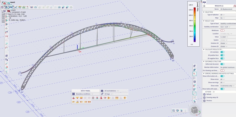

Hey everyone!
Perhaps you can give some advice on how to check if this steel arc will buckle under the specified ULS load. It's created in SCIA Engineer software. It has a span of 45 m. It's like a 1 m high steel truss with U-sections for chords and L-sections for brace members.
If you can point me to some hand calculation methods for this analysis, I would be grateful as well. But perhaps you can give me some advice on how to approach it in software? I can make stability combinations in SCIA and then it calculates me any amount of buckling modes I specify with a factor alpha_cr after them - basically it should mean that the structure will buckle under my load factored by that alpha critical factor.
A picture from my calculation model:
Software method: The elastic buckling analysis will give you the critical load. You use this to calculate the slenderness parameter that your design code uses for axial compression buckling (column buckling), then do the usual code checks for beam-columns. In the Australian/NZ codes, the slenderness parameter is Le/r but I think Eurocodes use something else. This blog (by forum member Agent666) shows how to do it in Aust/NZ and may help even if not your own code.
Hand check:
Apply dead load, plus live load to one half of the arch.
Calculate axial force and moment at quarter span.
Take Le = half the length around the arc.
Run your usual code checks for beam-columns.
I would use first-yield as the capacity for a new design but might be too conservative for an existing arch.
I also have a document that refers to charts in EN1993-2 but I've not seen them myself.
Thanks. But please elaborate:
"Apply dead load, plus live load to one half of the arch." - Why only half? Or do you propose I look at it as an inclined beam with a span of half the arc length and calculate internal forces for that inclined beam?
only half to give you an unbalanced load that would promote buckling of the arch.

I should have noticed earlier that this appears to be a circular arch. Gravity load will cause bending in the arch, so a second case of load over the full length should also be checked. The half-length load tends to be critical for parabolic arches because uniform vertical load doesn't cause bending.
You pretty much have to analyse the arch with a computer simulation. None of the elastic arch formulae accommodate the loss in stiffness due to the 'stick' web members... same thing with lattice braced column sections, although the lattice braced column sections have formulae for solutions. Second order effects can be real significant.

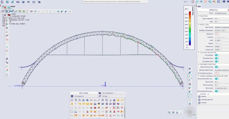

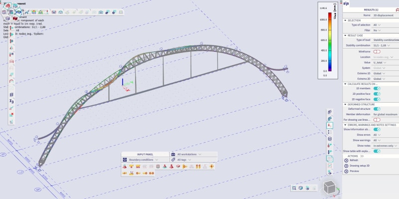

So I performed a linear stability analysis, I did 15 buckling modes. The first mode, with a factor of 2,88 times my asymmetric ULS load, the arc's top chord buckles out-of-plane - but in reality this cannot happen since the top chord is stabilized with load bearing sheeting, it's hard to define that in my model though. The second mode has a factor of 5,28 and the bottom chord buckles out-of-plane between longitudinal bracings (there are seven of these along the arc, I put supports at these locations). And after that starting from mode three with a factor of 5,85, the L-section brace members start to buckle here and there. Nothing happens in-plane to the chords in these 15 modes at least.
So what should I do next? :) I put a screenshot down here of the first and second buckling mode. As for the "initial imperfections", I'm not sure how to enter them, since the arc is made out of like 57 shorter members per chord.
The first buckling mode.
The second buckling mode.
EDIT: Okay, so I played around with it a little. I added an "intial imperfection" to each small segment of the arc's chord and the web members as well. You can set it so the software takes it from EC3, and it should be L/200 for my chord members at least.
So I performed non-linear buckling analysis with these settings and everything remains the same, though the factors are lower now of course - for the first buckling mode it is 2,0 and for the second one it is now 3,56. So is this fine? Can I say the arc does not buckle under my ULS load in-plane? The governing buckling modes are out-of-plane?
Nivoo, what's the buckling factor for mode 15? Is it much larger than mode 3, or is there a bunch with similar load factors?
I would still continue until in-plane buckling occurs and check against hand calc, or some other way of checking the computer analysis.

"Nivoo, what's the buckling factor for mode 15? Is it much larger than mode 3, or is there a bunch with similar load factors?"
There are a bunch of similar factors. So I did like 200 modes and number 139 seem more like in-plane buckling at 17,39 times the ULS load:
"I would still continue until in-plane buckling occurs and check against hand calc, or some other way of checking the computer analysis."
Okay, so in that case I think I should make a new model that's not a truss but rather a single curved member of a lot of sections to get the bending moment.
After that I think I would take the buckling length from EN 1993-1-2 that covers arcs. But what then - should I check that length as member in compression and uniaxial bending?

There are multiple types of buckling. Individual member buckling would still be done using the unbraced length of the individual member. It's the overall buckling (or moment magnification) of the arch that will get captured by a 2nd order analysis that includes initial imperfections which mimic the global buckling mode.
Global buckling isn't usually checked using unbraced lengths. Though you could mimic this by coming up with "effective" moment of inertia, effective area, and an effective unbraced length. In many ways, the method I described is a good way of developing what the "effective" unbraced length is from something like this. Though you could also do this by looking at the distance between inflection points in the buckling mode that you solved for.
You need to add a some lateral restraints (or springs) to represent the roof. At present you are not finding the buckling solutions that will occur with a roof in place.
