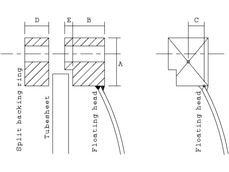

Regarding the Impact test, I have a doubt about the governing thickness reported in Fig. UCS-66.3.
Considering the following images, our software considers the following governing thickness of the floating flanges:
- Slit ring divided for 4,
- Floating flange: dimension B divided for 4
- Thickness of the floating cover
In accordance to Fig.UCS-66.3, should the thickness of the flange being considered (slit ring and floating flange welded)? Or should I consider the governing thickness given by the floating cover with the split ring as separate component? Moreover, in my opinion the split ring should be considered shell side instead of tube side, and how would the governing thickness of the split ring be defined?
Considering a different case, with carbon steel (ASME SA-516 Gr.70 for plates and ASME SA-765 Gr.II for forgings), in accordange to Fig.UG-84.1M, SA-765 has the minimum impact test reuired at -46°C, but in accordance to fig. UCS-66(3), I should consider only the minimum hub thickness.
My queston is, am I wrong if I consider oly the single component (flange), giving it satisfied for UG-84? Considering obviusly the plate for its thickness in curve D (UCS-66). Or, should I consider the MDMT obtained from plate also to evaluate the flange shell to cover? Regarding that, when I report that in a table, may I consider the flange joint with governing thickness and MDMT obtained from the governing component or would be better to distinguish them with component and material?
Thank you so much in advance
OP,
You have asked a bunch of questions in one place.
My first question is - is the backing device (split ring) and the floating head flange even correct? Usually, the split ring should have the step going over the tubesheet OD. The floating head flange face should be straight with the pass partition gasket coming in between the tubesheet and the floating flange.
In regards to picking up the governing thickness by the software, it is correct.
On Fig UG-84.1M, it;s all about impact test requirements for Charpy Test. Where do you get -46C from? Charpy tests have to be done at specified test temperature by you, which should be at or colder than the vessel/HX MDMT.
GDD

Thank you GD for your answer,
I just shown an imagine where spit ring (back ring) had a generic indication. Our floating flange will not be absolutely that.
Thank you so much!
