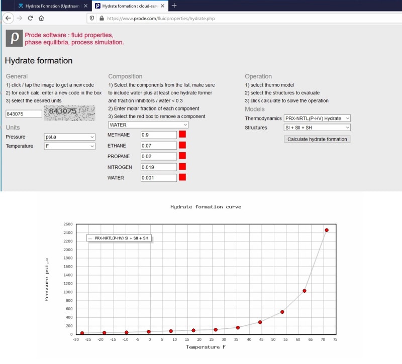

i have a gas expanding thru a control valve ...upstream pressure is 400 psig and downstream is 50 psig
upstream temp is 80 F and downstream is 50 F
At upstream pressure hysys show hydrate formatiion at 56 F
at downstram pressure hysys show hydrate formation at 35 F
What should be considered ...will hydrate form? since downstream temp. 50 F > 35 F so no formation?
which pressure should be considere for analysis?
given composition, hydrate formation temperature depends from pressure,
see the attached image created with the free online calculator
You need to look at both but from your days it doesn't look like you have a hydrate problem.
