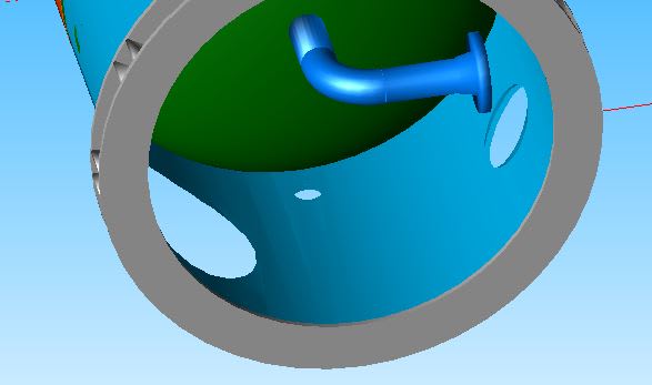

Hi experts,
I am modelling a vessel which has a nozzle as shown in image, need guidance on how to model this type of nozzle shown at the bottom?

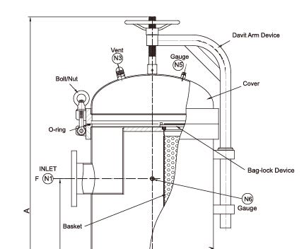

Hi CuMo, I am struggling in making davit arm in PV ELITE, can you please help again?
Please, do not duplicate post.
Regards
PIP Standard drawing VEFV1119 Vessel Column Davit may be used, and no calculation is required.
I don´t know dimensions of your example.
Regards
This special davit may need hand calculations for the arm and support clips. See Dennis Moss design manual for guidelines. Also check weld strength and local stress on shell.
