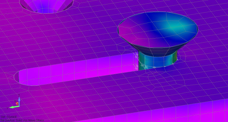

thank You for Your answer. It led me to the conclusion, that it was something wrong with my model. I spent a lot of time reviewing the model but finally came upon some issues:
1. I used CTETRA 10-noded elements for bolts and CHEXA 8-noded elements for plates, in which holes for the bolts are made, which was obviously wrong.
2. When I corrected the mesh, I still did not get the convergence, but I found out that the bolted connections became unstable during the analysis, so I pre-stressed the bolts, which led the analysis to converge and get me the results.

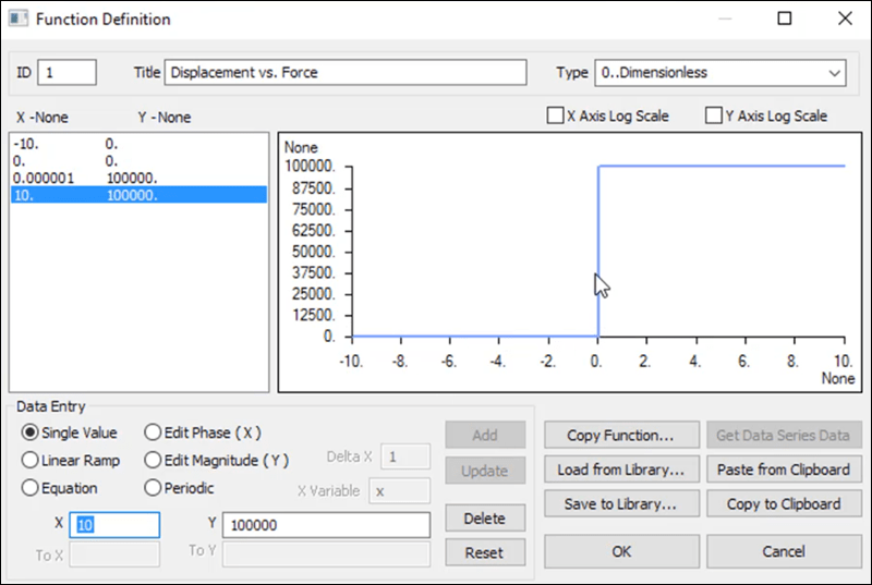

Another thing I am dealing with now is CGAP elements which I found out to be not supported in SOL401. Is there any other way to introduce one-directional contact between the bolt and the slot in SOL401 nonlinear analysis?

Dear Michal,
Yes, with Simcenter Nastran Multi-Step Nonlinear (SOL401) you can use CBUSH elements as a ONE-DIRECTIONAL COMPRESSION-ONLY CONTACT-ELEMENT, the CBUSH element type is impressing for nonlinear analysis!!.
The key: you can define a nonlinear function of displacement vs force like of the following image: when displacement is negative, then no stiffness, when displacement is positive, then infinite stiffness (well, for instance 1e6).
You have also the CBUSH1D element supported in FEMAP V2021.2, that is a one dimensional version of the BUSH element (without the rigid offsets) and supports large displacements.
Take a look to the following video:
