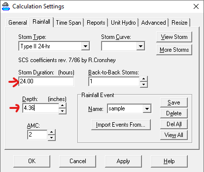

I have precipitation depth for 11 hours and I want to use this storm data to create a rainfall event to do the analysis, does anyone know how to do that?
I attached my HydroCAD model and the last thing to do is to create the rainfall event.
Besides, what is the P2(2yr-24hr Rain) I should type in for my sheetflow if I create my personal defined rainfall event.
Thank you.
I don't think you have enough data to calculate the 2yr-24 hour storm. You have only 11 hours worth of data and you're trying to predict the amount of rain for a 24 hour period that will occur 50% during any storm event. Your data indicated 2" of rain in 11 hours, but who knows how that relates to an 11 hour storm. To get the 24 hour storm could you calculate it by 2"/11 hr x 24 hours = 4.36"? Actual precipitation data can be obtained at the following website:

What what we can do is to adjust the rainfall depth as shown in the image (2"/11 hr x 24 hours = 4.36 inches)?
Your advice on setting this up would be greatly appreciated.

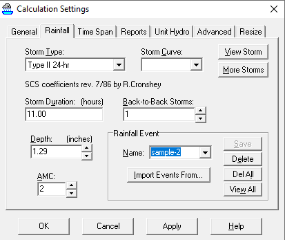

Now if I know the storm duration is 11 hours, and the total depth for these 11 hours is 1.29 inches. Do you think it is accurate to do it in the following way (as shown in the snapshot)?
Or I have to use the "Sample F" rainfall file to define a rainfall distribution with uneven time steps.
No! Scaling a Type II 24-hour storm will NOT give you the intended rainfall distribution. You need to use the custom rainfall distribution you've been working on. Just add your rainfall depth on each timeincr line and you're all set. Very easy. Note that your overall duration will be 11.52 hours, since that is your last time value.
