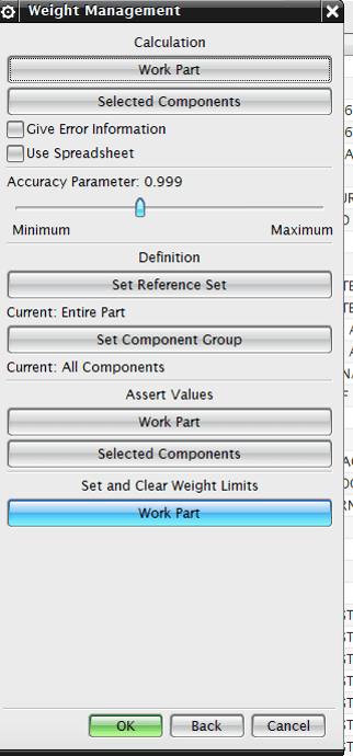

I need to remove/undo a previous weight assertion on a component. I am now able to assign densities to all of it's contributing bodies so I no longer need this assertion.
I don't think this dialog have changed in ...many releases.- The path to the dialog have so...:
Go Analysis ....something .... advanced Mass properties - Advanced Weight management - Assert Values ( on work part or selected components)
there should be button far down "Remove assertions".

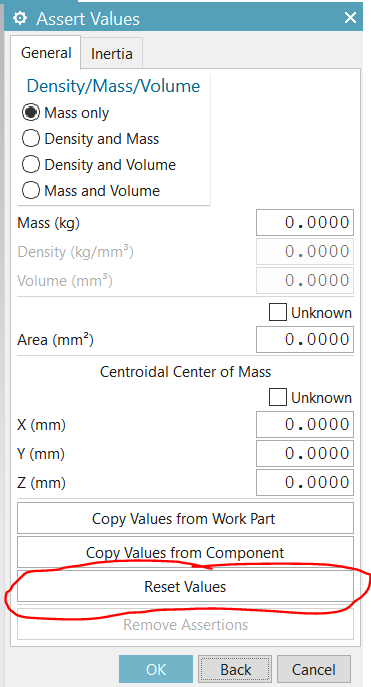

Thank you but there is no "remove assertions" option.
Under Assert Values click Work Part or Selected Components and in the new form you have a Reste Values button.

Thanks but mine just automatically does the calculation and is done w/ no further dialogue when I click those.
If I click on this button.
I gott this new form.
This is from NX12.0.2 MP12

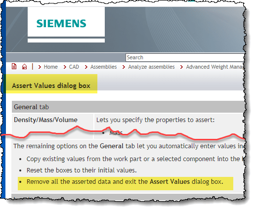

I don't know if you can access this page or not. this is the old documentation webpage. It includes the NX8.5 manual.
Klick the NX8.5 button then NX8.5 Help
You should then be able to browse down to
( the new documentation page has nothing older than NX10

Not sure how I missed that but thank you. That worked!
