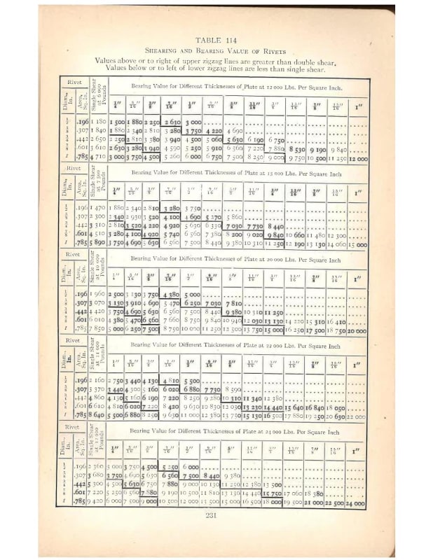

Does anybody know how to determine rivet shear strength for 7/8 inch hot rivets (or rivet properties in general) installed in 1915?
Rocks1, see table below. This is from my copy of "Structural Engineers's Handbook", Milo Ketchum - 2nd edition circa 1918.
The scan quality was crap for some reason - if you need any info from the table that isn't clear, just let me know.
I don't have access to it right now, but AASHTO MBE also provides a codified value for rivet shear strength.
