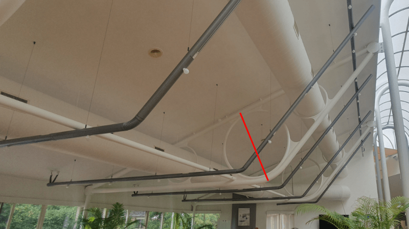

Hooped Truss 1
Neat! Thanks for sharing Steynv.
It's hard to know but, if this thing was "designed" at all, my money is on:
1) At the least, I'd be tempted to call it a kingpost truss with the big hoop in compression.
2) You'd get some Vierendeel action but I suspect that would wind up being pretty soft.
Yea, I'm surprised it works.
I suppose FEA had the answer
The green tubes have cables going up to the ceiling for support.
Is there more structure up there out of sight, or is that a slab spanning across there and also supporting the green tubes?
Where the white/hooped trusses connect to the columns, that does not look like a very beefy connection, which makes me wonder what they are actually supporting.
