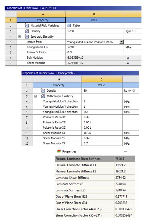

I am using ansys not nastran to model composite honeycomb. Both facesheet and core are aluminum, and I use lamination method to calculate the effective E, G and poisson ratio. Can I use these data with isotropic material model or I have to use orthotropic material model?
When I tried to use orthotropic material model, I could not get a reasonable results as I set all thru thickness properties to 1E-6. I get the result similar to isotropic model when I use same shear modulus in three axes...

I make assumption for the core properties (set the modulus, shear modulus and poisson ratio to small value in three directions) and then I model the stack up Al facesheet + Al HC core + Al facesheet in Ansys but I notice that there is buckling mode appear in modal analysis which I do not expect it happens.
Same issue happen if I assume the Alu sandwich as orthotropic material with assuming very small value in thru thickness properties for G13, G23.
Note: I obtain E11, E22, V12 and G12 from lamination calculation and I use it to model sandwich in single shell by assuming it orthotropic.
Appreciate your thoughts!
Ok, please post the exact properties that you are entering to Ansys, and the sandwich panel materials, material properties and thicknesses of the facesheets and core.

[UPDATE]
The plate shear modulus unit was wrong. The result looks reasonable after I fix it. Appreciate everyone for your kindness!
0.5 mm facesheet (Al 2024) + 9 mm HC + 0.5 mm facesheet (Al2024)
Based on the lamination calculation, E11 = 7240 Mpa, G12 = 2758 Mpa and V12 = 0.33
It seems the honeycomb core thru thickness properties might be wrong. I am checking the properties ...
