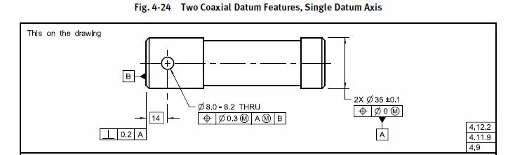

From a purely theoretical standpoint, to communicate everything clearly I think the designer does need basic dimensions and position tolerance, but I think datums are not mandatory. If no datums are specified, the position tolerance would control only mutual location and orientation of the holes to each other, but the entire pattern can be anywhere and at any angle relative to the rest of the part. I am not 100% sure though, as I am used to seeing datum-less position only at the lowest segment of a composite feature control frame.
chez311 or others, can a single segment position tolerance be datum-less?
Datumless position of a pattern is allowed, whether a single segment or part of a multiple segment/composite tolerance, and there are certain instances where it is useful - say when the pattern of interest is itself a datum feature to be referenced by other controls, or when the pattern is controlled with some other mechanism and the datumless position is a refinement.
See below for an example of a single datumless FCF used as a datum feature reference for other controls: (Y14.5-2009 fig 4-24)
Thanks for the reference - this is what I was looking for.
