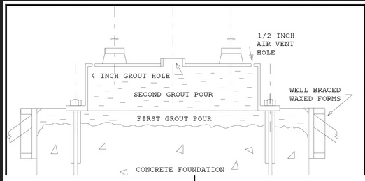

In your picture what the heck is going on underneath the pump and motor? It doesn't look like they are sitting flat on anything, or if they are it doesn't extend to the edges. I believe good practice is to completely support each pump and motor foot underneath. And no bolt on motor gearbox end foot I haven't seen that before... maybe an attempt to relieve stress on the mount to the gearbox? I'd think the better solution would be to shim and slign the motor to remove stresses at least in absence of large thermal growth although we don't have any analogous machine where the motor and gearbox would both be bolted to the base.
Your mounting plate as shown in the picture is way to flexible to get good vibration data. If you were using laser coupling alignment you would detect "soft foot".
The simple way to fix this is to fill the space between the floor and the plate with cement or epoxy grout. Pinning the grout to the floor is highly desirable.
Here are some useful, easy to follow directions for grouting pump base plates. 7 Steps to Grouting a Pump Base
Grouting the pump base will have the side effect of changing the resonant frequency of the piping system which should reduce the magnitude of the pipe vibrations.
agreed. It's a plate on stilts. The stilts can bend (which might be be expected to give directional vibration in the horizontal or axial direction), or the plate can flex.
Both the configuration above the plate and the configuration below the plate look different than any standard installation I have ever seen. Looking at that I'm not surprised that machine has high vibration. Although I am intrigued to know if it used to be lower (how much lower, and what changed)
