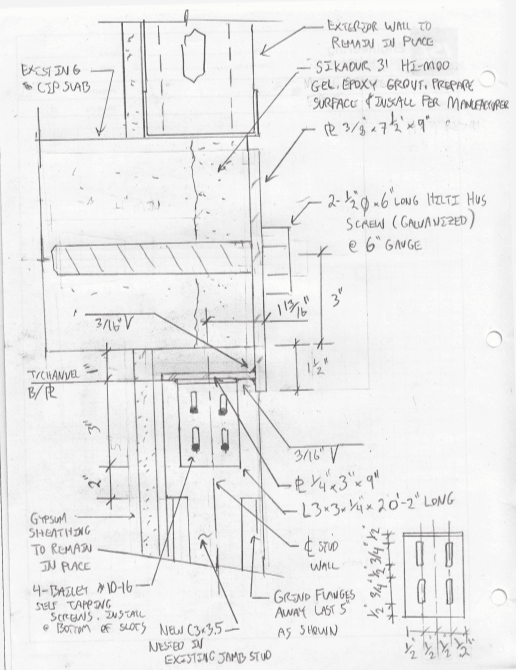

High demand 3-5/8" jamb stud connection cantilevering 2" past rough slab edge.
KootK
Oct 16, 2001
18,601
This thread introduction may well be too long for busy folks to read. If so, you can probably get a pretty good jist of it just by scrolling through the graphics. I won't be lambasting anybody because they bring up something that I have already mentioned in the text.
I've presented some possible solutions below that I would like to have vetted by the gang. Naturally, I would also be utterly thrilled to entertain alternate, better solutions. In my heart of hearts, I'd like to rip out the walls and replace them with the 6" studs that should have been there to begin with. That would not be good client care in this instance however.
THE SITUATION

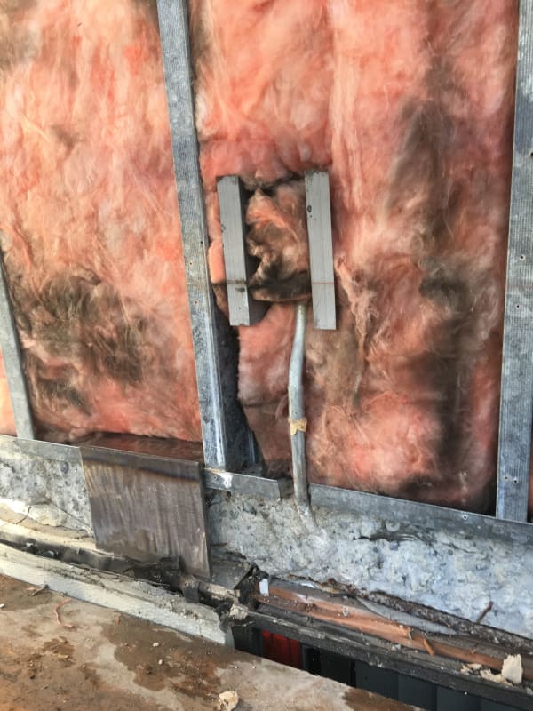

1) existing 3-5/8" jamb stud for a rather large wall opening in a highrise condo.
2) jamb stud will deliver about 1500 lbs ULS wind shear to its slab connection.
3) jamb stud is already being reinforced with a nested, 3" steel channel.
4) original connection design was some aggressively designed clips and concrete screws.
5) site work has revealed that, in some locations, the slab edge was originally saw cut as shown in the the photo below. Some kind of field error presumably.
6) my hardworking jamb stud connection now has a stud cantilever of up to 2".
7) expensive folks are standing around on site seeking direction.
THE CONSTRAINTS (AT LEAST FOR NOW)
8) Existing wall system is to remain in place during repair. Exterior sheathing will come off.
9) Need a solution that works for stud cantilevers ranging from 1/2" min to 2" max.
10) No field welding.
11) Need to be a little sensitive to building envelope concerns. I can, locally, have a bit of steel that would project into the exterior sheathing/insulation space.
THE OPTIONS CURRENTLY TABLED
OPTION 1. For a short length of slab, feather out the slab edge with repair concrete somehow. This would, ostensibly, be pretty great. Can that be done in such a way that we'd trust that repair concrete to be able to handle the fastener shear loads coming in from the jamb studs though? It gives me the heebee jeebess. I also worry that it's hard to do without removing the existing stud work. I would be interested to hear if this solution is viable and, if it is, recommendations for appropriate materials and procedures.
OPTION 2. This is a clever solution suggested by the client. My main concern with this is the viability of the grouting which would need to work at thicknesses ranging from 1/2" to 2". If the grout is installed before the bolt, will it just fall off during drill & epoxy'ing of the bolt? Would it be feasible to install the bolt first, grout around it, and then attach the angle? Could the bolt and angle be installed first, with the angle kept still somehow, and then grout be stuffed in behind the angle as a final operation?
OPTION 3. Similar to option two but no longer reliant on grouting feasibility. It's just... kinda silly looking. I would like to do something similar with a single back side nut, much like traffic sign structure bases are handled sometimes. Given the access situation, however, is there any way that I could use a single, backside not and be confident that it would be locked in place for the long haul? This would be easier at the 2" dimension and harder at the 1/2" dimension I reckon.

I like TME's setup with the notched angle. Looks like it would provide a solid connection to the stud.
If having it stick up above the floor is unacceptable, you could cut/grind out a slot in the concrete to recess the plate/angle leg, countersink the holes and use flat-head tap-cons (Might need more than 2, though) or drop-in expanding anchors like one of these and flat socket cap screws.
That's another way to accomplish the flush condition, kipfoot. Just have to make sure the concrete is chipped out to accommodate the fillet weld, or use a thicker angle and thread the hole (that requires a way to lock the threaded rod in place, such as high-strength threadlocker or a small tack weld on the top or bottom)
Interesting development: apparently fire rating from the out side means that I can't have any connection plates projecting past the exterior face of stud. Botls and nuts ok I guess.

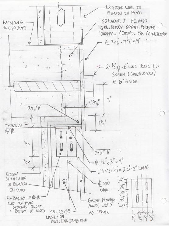

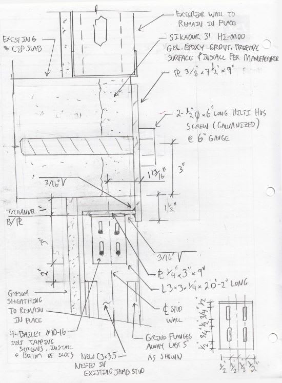

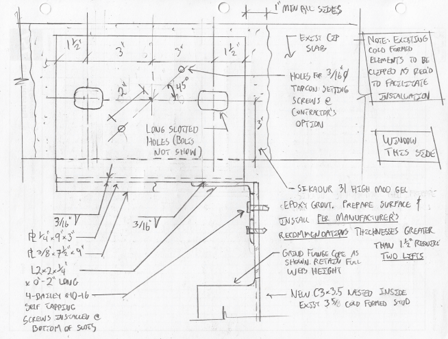

1) I would like to thank everyone for their contributions on this. 'Twas a great help.
2) See below for the current solution. If anyone spots any issues, I would love to hear about them. You know, other than ridiculous cost.
You know when you develop a complex detail to solve an overly constrained problem and, at the end, you look back and say to yourslef yeah, that's just waaaay too much? This is that for me I'm afraid.
Yeah the welded arrangement makes that no fun.

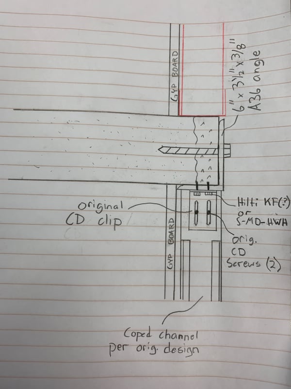

Are you not comfortable with just running your original Kwik-Cons into the grout, hence the need to provide a different load path through the steel? (not saying you should be comfortable with that, you've done the math I'm sure).
6" x 3 1/2" angle is an off-the-shelf size. How about:
That's right, I am not comfortable relying on the grout repair to serve as equivalent to original concrete from the perspective of anchor edge performance. To be frank, I didn't run any numbers on that. I don't actually know how to. It came down to just my visceral feel for whether not I could trust the patch to be stuck on there awesomely. In a way, I was kind of hoping that I'd come here and hear a whole bunch of "don't be silly, just count on the screws in the grout!". But, alas, I did not hear that. As a data point, can you tell me if you would be comfortable with just the original screws in the grout repair? Better still, do you know how to run the numbers on that?
That is tempting. Here's what went into my decision not to do that:
1) I'd shift the angle down to miss the slab edge with the heel fillet. With the bolt remaining located where I put it, this would take my lever arm on the bolt down from 2" to 1". I could probably deal with that anchor wise or I could move the HUS anchor down a bit.
2) The 3.5" angle leg is only 1/8 shy of the inside face of the drywall. So not much tolerance for the depth of the concrete repair. Would it be the end of the world if the angle leg had to squish into the drywall a bit? Probably not.
3) I worry about accessibility and workers' ability to drill in this small cavity. Normally, when these kinds of clips etc are being installed, it's with no sheathing on either side which is obviously more forgiving. As qualitative antidotes to that:
- I set it up to eliminate the vertical screws between clip and bracket.
- I set it up to shift the horizontal screws further from the drywall than the would have been with off the shelf CFM hardware.
- I set it up so that, even if the column of screws closest to the drywall can't be installed, the numbers still work.

One major point I missed when reading your solution- your original constraints called for no field welding. When I saw welds in your sketches, I was confused- until just now when I realized that, duh, there's nothing preventing your arrangement from being welded before it's hung.
Also, access for placing the fasteners is a major problem, no doubt about that.

I agree that would be desirable but that is not my current intention. A few reasons for that:
1) With the grout gap being as little as 1/2" and rough, I wasn't confident that grout could be poured / packed in all instances.
2) As currently envisioned, we don't have top side access to this thing into which we would pour goop into the "form".
3) Having a nut, while great for adjust ability, make for more of an envelope protrusion.

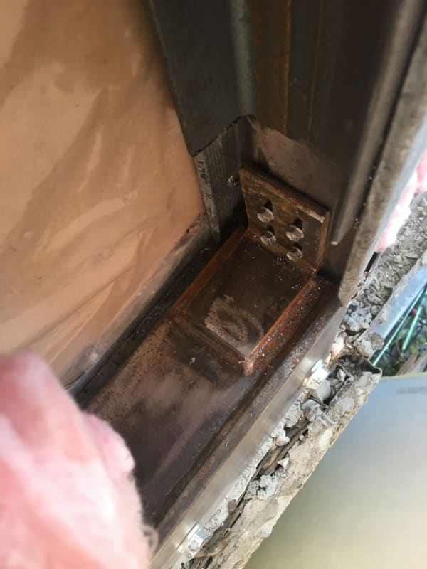

Well... I'm flattered by your continued interest in my little problem jgKRI. Thanks for that.
Yes, I did go with my last pitched idea. I'll post the final sketches below.
After seeing your latest post, I queried the contractor for some site photos which I was owed anyhow. I'll post those too.
The most interesting part of this ended up being the choice of Sika product for grouting. It unfolded like this:
1) I asked my Sika rep what product I should use and indicated that I was considering the Sikadur 31 epoxy system.
2) Sika rep said "we agree, Sikadur 31 will work for this applicaiton".
3) After some concept vetting here, I inquired again to the tune of "While I understand that Sikadur 31 would work, is that your recommendation for the best option for this application? Perhaps Sikatop 123 would be better?". That, per TME's input.
4) Sika rep said "yes, Sikatop 123 is our recommendation".
5) After a little research, I went to the contractor and said "hey, this Sikatop 123 might be a better choice than the Sikadur 31 that I originally specified. If you want to use it, I'm fine with it. The one caveat being that the Sikatop 123 requires a heating and hoarding period if temperatures will drop below freezing overnight. Even in December, an over night freeze in Vancouver is unlikely, but you never know".
6) The contractor, being rather adventurous, said "nah, I'm curious to try the Sikadur 31 anyhow and the hoarding may well be a problem. Let's stick with the Sikadur 31".
7) During the install, the contractor called and said "this stuff is very stiff and nearly impossible for me to work with. Can I switch to the Sikatop 123?".
So the correct answer here ended up being the Sikadur 123.

Thanks for the update. Looks like your solution worked out very well.
Interesting dialogue as far as working out which Sika product to use.
How well did the contractor take your proposal overall?
appreciate the follow up/closure....and wow that is one nasty looking slab edge in those photos it almost looks like a chunk spalled off during construction and was disposed of w/o any subsequent patching..odd.
