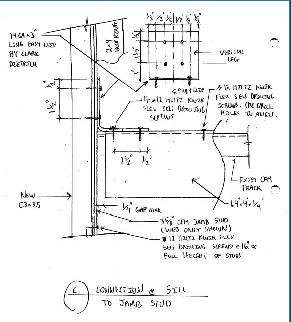

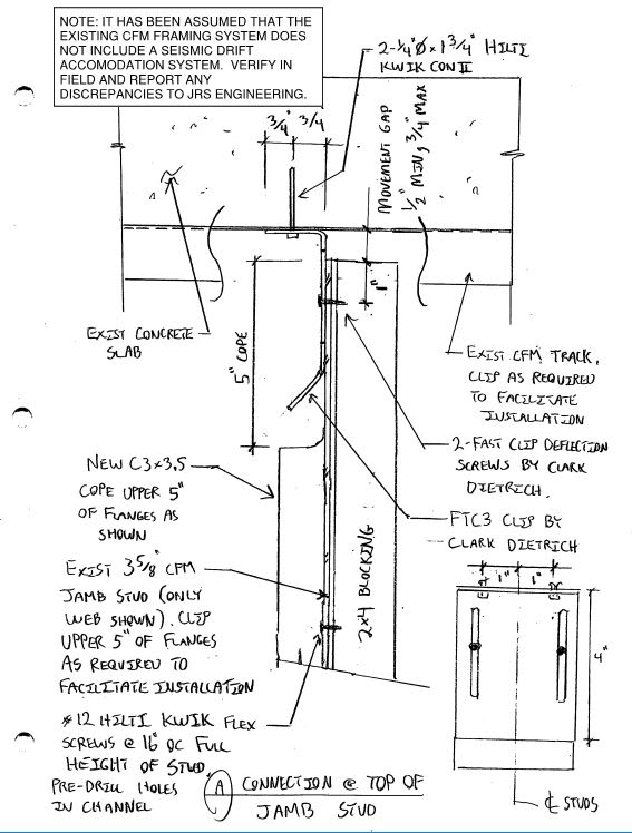

High demand 3-5/8" jamb stud connection cantilevering 2" past rough slab edge.
KootK
Oct 16, 2001
18,601
This thread introduction may well be too long for busy folks to read. If so, you can probably get a pretty good jist of it just by scrolling through the graphics. I won't be lambasting anybody because they bring up something that I have already mentioned in the text.
I've presented some possible solutions below that I would like to have vetted by the gang. Naturally, I would also be utterly thrilled to entertain alternate, better solutions. In my heart of hearts, I'd like to rip out the walls and replace them with the 6" studs that should have been there to begin with. That would not be good client care in this instance however.
THE SITUATION
1) existing 3-5/8" jamb stud for a rather large wall opening in a highrise condo.
2) jamb stud will deliver about 1500 lbs ULS wind shear to its slab connection.
3) jamb stud is already being reinforced with a nested, 3" steel channel.
4) original connection design was some aggressively designed clips and concrete screws.
5) site work has revealed that, in some locations, the slab edge was originally saw cut as shown in the the photo below. Some kind of field error presumably.
6) my hardworking jamb stud connection now has a stud cantilever of up to 2".
7) expensive folks are standing around on site seeking direction.
THE CONSTRAINTS (AT LEAST FOR NOW)
8) Existing wall system is to remain in place during repair. Exterior sheathing will come off.
9) Need a solution that works for stud cantilevers ranging from 1/2" min to 2" max.
10) No field welding.
11) Need to be a little sensitive to building envelope concerns. I can, locally, have a bit of steel that would project into the exterior sheathing/insulation space.
THE OPTIONS CURRENTLY TABLED
OPTION 1. For a short length of slab, feather out the slab edge with repair concrete somehow. This would, ostensibly, be pretty great. Can that be done in such a way that we'd trust that repair concrete to be able to handle the fastener shear loads coming in from the jamb studs though? It gives me the heebee jeebess. I also worry that it's hard to do without removing the existing stud work. I would be interested to hear if this solution is viable and, if it is, recommendations for appropriate materials and procedures.
OPTION 2. This is a clever solution suggested by the client. My main concern with this is the viability of the grouting which would need to work at thicknesses ranging from 1/2" to 2". If the grout is installed before the bolt, will it just fall off during drill & epoxy'ing of the bolt? Would it be feasible to install the bolt first, grout around it, and then attach the angle? Could the bolt and angle be installed first, with the angle kept still somehow, and then grout be stuffed in behind the angle as a final operation?
OPTION 3. Similar to option two but no longer reliant on grouting feasibility. It's just... kinda silly looking. I would like to do something similar with a single back side nut, much like traffic sign structure bases are handled sometimes. Given the access situation, however, is there any way that I could use a single, backside not and be confident that it would be locked in place for the long haul? This would be easier at the 2" dimension and harder at the 1/2" dimension I reckon.

4) How about a bent plate solution? I`m envisioning showing up to the site with a bunch of pre-bent plates of various widths (L4x1/2, L4x1, L4x1-1/2, etc). These plates would be pre-drilled and anchored to the concrete (mechanical or epoxy) and self tapping screwed to your new hot rolled C reinforcing. There are some challenges there, but I think that concrete reinforcing/repair is minimized or eliminated. Maybe the cantilever is a red-herring and the L4x1/2 bent plate could be used everywhere.
"I might need a sketch to understand that."
Here you go; I hope it helps.

I'm actually a fan of bones' suggestion if it's tolerable in the rom in question on all floors. Yes there is a loss of floor space, but damn if it isn't the easiest solution. Some flat plate light gauge clips from existing studs to new studs, jamb extensions on the windows and Bob's your uncle.
If the main concern, or you're being forced to limit your liability to the jamb studs only. How about providing a small pilaster on either side of the large opening so you can provide an angle clip connection on the inside face of the jamb studs. They furr out around the connection.
Ah, geez; I get too busy during my reply, refresh, and the thread gets 400% bigger. Now I have to start reading all over. Darn you for having really interesting but really lengthy topics! [thumbsup]
I've done option #1 before in similar situations but only with positive connection crossing the cold-joint. Either with drilled and epoxied rebar or powder-actuated fasteners. I've done non-structural repairs of concrete without steel crossing the joint and between the contractors ignoring any bonding details (saturated surface, cleaning up dust and loose aggregate, etc.) and the lack of attention to curing; the repairs are not ideal for bonding to the existing and I would not have trusted them.
In short, I'd do option #1 only if forced to and would require continuous inspection of the process.
I agree with jgKRI's post entirely. A wedge anchor is going to be more cost-effective over epoxy anchorage and will install faster with less skill required on the installers part. I also agree that the existing surface looks fairly good for bond already; simply remove the loose bits, clean any dust, wet and skim coat, and epoxy grout.
I'd probably not use such a large steel plate, unless you really wanted to. I suspect you could utilize stainless steel plate washers and get sufficient bearing with those alone. The wedge anchors could also be stainless steel without too much expense and this should eliminate any corrosion concerns for the repair.
Ran some quick numbers on a typical wedge anchor. Looks like 3/8"Ø gets you there but 1/2"Ø would give you even more safety factor. Will need to make sure you have enough length though; often times wedge anchors have a set length and your embed might not be enough for the up to 2" of concrete. Perhaps a coupling nut embedded in the grout?

Something of that sort will be how I attache the angle clips to the channel reinforcing. It was how I was connecting to the concrete back when I had some.
Here's the original detailing back when I had slab edge. I didn't include it originally because I didn't want to over complicate things. Clearly, though, I'm just withholding meaningful context to smart folks who are working hard to help me.

3) Many of the above sketches are only addressing the condition at the base of the jamb. This is also a problem at the top of the studs, correct?
Yup, per the quote below. Don't worry, I don't expect anybody to be keeping up with all this.
KootK said:
2) Need to deal with top of slab and bottom of slab connections simultaneously at many location.
3) Consideration of vertical slip at top which is made extra awkward by the fact that there is no allowance for that now.
Not sure how this gets fastened into the concrete as the edge distance problem still exists, right?
Hilti is the anchor manufacturer with whom I am most familiar. 1/2" Kwik-Bolt anchors are available in stainless steel in 6" (in 304 SS) and 5.5" (in 316 SS) lengths; design strength for these anchors are more than 2000 lbs each, with only 2 5/8" of embedment in 2500 psi concrete.
For a closer-to-flush head, you could use a screw anchor. 1/2" screw anchors are available @ 6", and have a design load of about 1500 lb per anchor with only 2 1/4" embedment in 2500 psi concrete.
My thinking on this is that you would not want any tension load applied in the new concrete- you'd want an appropriately sized hole all the way through the new placement, with all anchor tension applied into the existing slab, which means you'd have to over-drill the holes for screw anchors to a controlled depth; this might be a pain.
Wedge anchors are probably the cleanest overall solution, but you may wind up having to trim some of them after they are installed. If you use stainless anchors that's no big deal, with carbon steel anchors you're exposing the core so you have a corrosion concern to deal with.
Disclaimer- I don't work for Hilti, verify my numbers (obviously)

Kind of along the pilaster idea; we realistically only need to get tension back into the slab, right? The compression load from the stud could be transferred into the slab with option #1 easily enough.
Could you suffer a steel angle on the floor without messing up the finished floor elevation?
See attached. Might even get this to work for compression in the notched angle as well.
Edit: Reading more; maybe I'm unintentionally copying what jayrod is suggesting and I'm just skipping the pilaster?
I`m not sure how to post sketches, but I`m envisioning a bent plate aligned vertically.
The 4" leg would run parallel to the face of concrete and bolt into the face of concrete. The fastening to the concrete is a bolt, similar to your sketch #2.
The 1/2" leg would run along the stud. Fastening via self tapping screws - either through the bent pl into the stud, or better (?) through the stud into the bent pl.
This may have the added benefit of using one bolt into the slab edge to address both the jamb above and the jamb below (assuming they align)
These predrilled holes for the self tapping screws could be slotted to allow for your slip.
Like the attached? EDIT: Re-reading your post I've misunderstood your intent it appears. Do you think you can figure out how to post a sketch as it sounds interesting?
