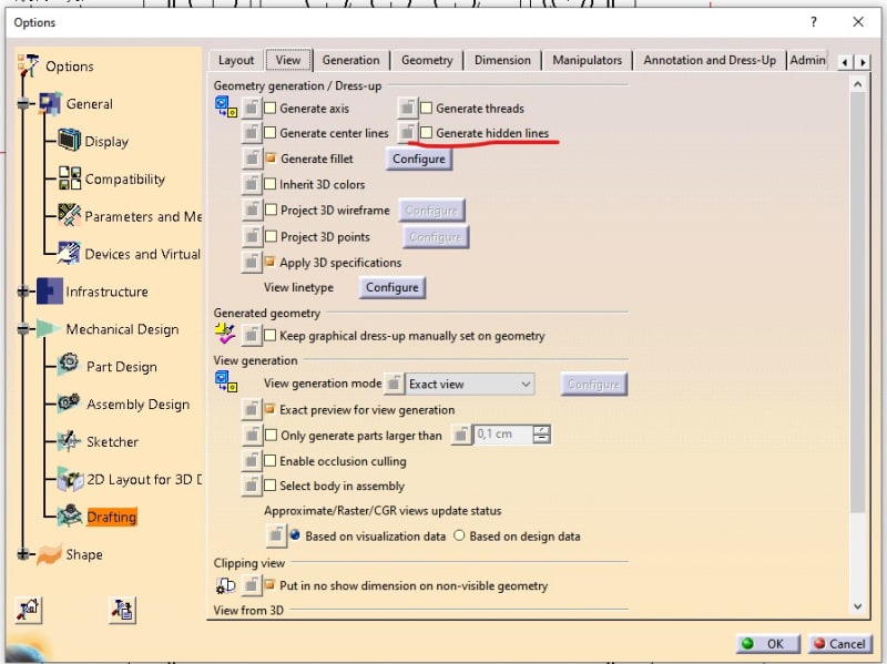

How do you set drawing views to show hidden lines by default? Catia V5
Wuzhee, thank you, but on mine that is greyed out. Do you have any idea what would be causing it to be grayed out.
The catia default settings file might be locked by your administrator.
