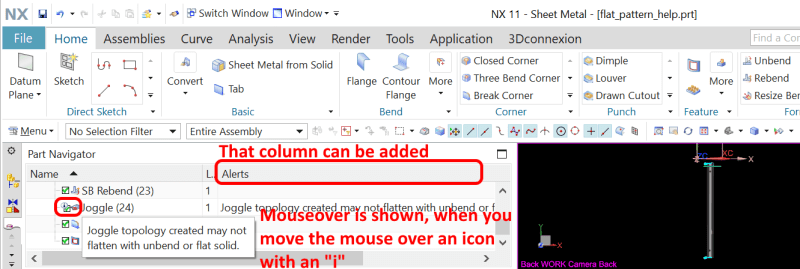

I would say it's software limitation. In feature tree the Joggle gives already an alert: "Joggle topology created may not flatten blabla". Try a different way or contact GTAC. Same story in NX Continuous Release 1847/2400.
Can you show a picture of that joggle ?

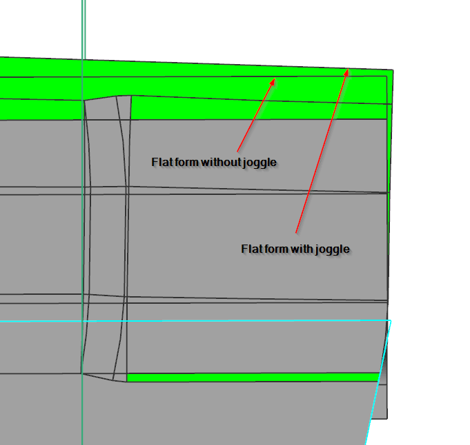

The flat pattern currently will not support joggles that are created on 'intermediate faces'; ie faces that have flanges either side. This is a limitation. Recommended current workflow is to either:
1. Create the flattened form without the joggle (The flat form is of course different without the joggle geometry however I'm not convinced it makes significant difference in practise?)
2. Use Forming/flattening tool from freeform tools
3. Use One-step or Metaform
