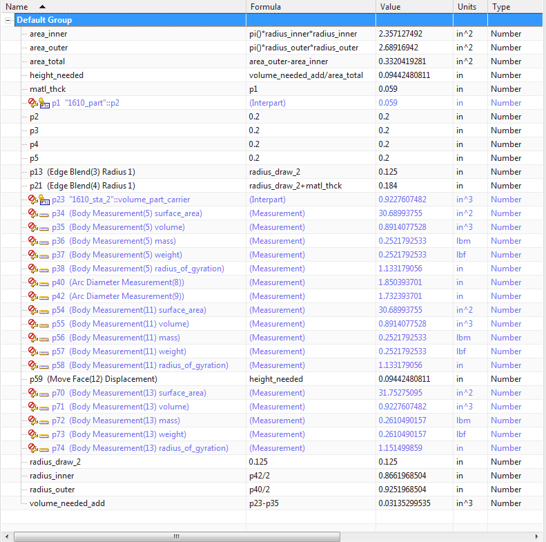

I am trying to create a formula in expressions to calculate the height of a tube given the outer radius, the inner radius and a volume desired. I keep getting syntax errors. The radii and the volume have there own expression establishing there values.
Thanks, Fred
I probably should clarify the radii and volume values are established from measurement expressions.
Thanks, Fred

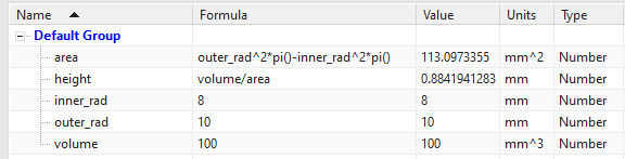

Keep the area and height expressions, reference your expressions for the radii and volume.

I got it to work, but I had to break all the variables down to separate expressions. It would be easier if I can create one formula expression for the "height needed"
Thanks, Fred

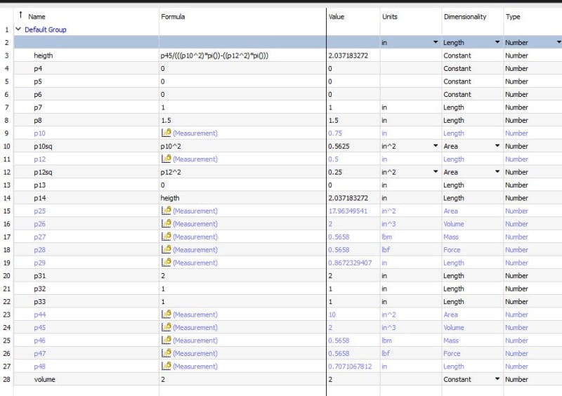

Here's my take on this. Sometimes I find I have to play around with "Dimensionality" to get formulas to work.
