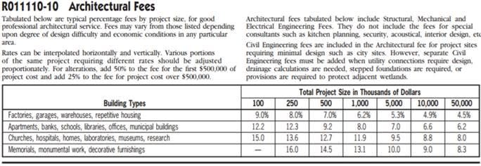

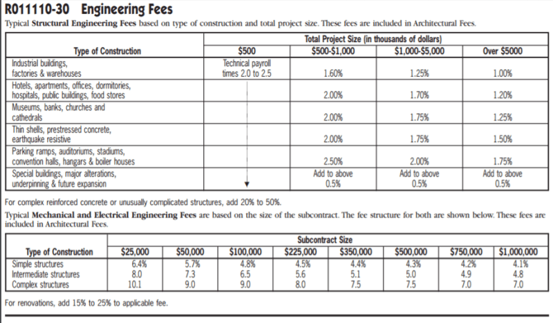

I found these from a few years ago.
Great information @haynewp, however in my experience those numbers are over double what you would actually get for most markets.
It’s from RSMeans. I agree it’s high but definitely what we SHOULD be getting for the life safety responsibility we take on.
So if you use the table on the custom home in the OP. 5000 sf * 250 $/sf * 1.6 % = 20,000 $. People were throwing out numbers like 12k to 17.5k. Those are all under the value derived from the table and range from 60% to 88%. Thats interesting...
GC_Hopi that table looks like it comes from RSMeans. Don't put much stock into it (EDIT - sorry already mentioned above). I use RSMeans for estimating construction projects from time to time but if you don't already have a ballpark of your market numbers +/- the tables will kill your bid (in either direction). They are a good order of magnitude guideline but I wouldn't use them for anything more than that.
Assuming the locality multipliers are the same for construction, my market has about a 16% reduction. So I'm a little lower than the means table suggests, but not significantly.
