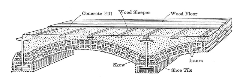

My company was called in to look at rehab and renovation on a jail built in 1901. From a historic sign, I know the builder for the jail was the Pauly Jail Building Company. For a large chunk of the building, it is what you would expect from a turn of the 20th century building URM with wood joist framing over a crawlspace. However, for the "lockup" portion of the building, there is a floor framing system that I have not seen before. Essentially, it looks like S8 (or equivalent) beams spaced at roughly 36 inches in an arched corrugated form supported by the beam bottom flanges. In the larger spaces, there are steel beams (S12) that provide intermediate bearing support for the embedded beams. I did my best to use the Wayback machine to look at the information on slideruleera.net, but I didn't see any system that matched what I saw. I am wondering if anyone has run across this system before and might have some information about it. See the pictures below. I will note that some rehab appears to have occurred recently, but no one in the project seems to know what happened and when.
This is an example of an arched tile floor similar to what I think you have here.
The tile was utilized to create a level of fire protection where your jail situation may not have had the same concern, if any, for fire protection.
The floor "capacity" would be based on the steel beams supporting the arches - the floor arches probably have more strength than the beams but you'd have to investigate the thickness of the floor at the center of the arch span against punching shear resistance.
In some cases with flatter arches such as this they used a horizontal spacing of tie rods between the beams to keep the arch thrust from spreading the beams apart.

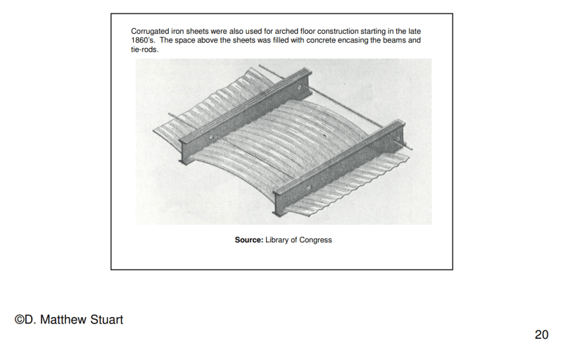

This image below came from the "Antiquated Structural Systems" articles by D. Matthew Stuart in the Structure Magazine, December 2007.

I can't see this being a "system", more than it looked like a good way to self support the presumably concrete floor above without needing framework. What is the floor above and what sort of thickness is there?
Maybe this was the way they poured concrete floors in 1901?
Or they had some excess corrugated sheets.
