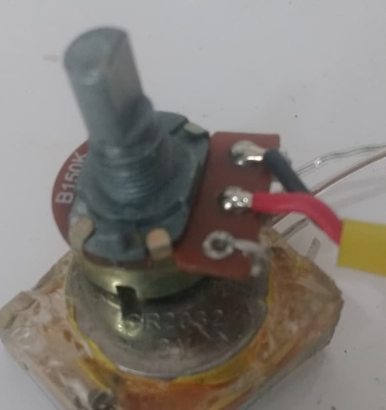

I need to design a dimmer, but I'm having a problem with the potentiometer, that heats up too much
It's 150k, and it's practically impossible to get a different one
The same problem goes to the diac/zeners: also difficult to get a different one. Right now I'm using the DB3 diac, that conducts after 31V, symmetrically.

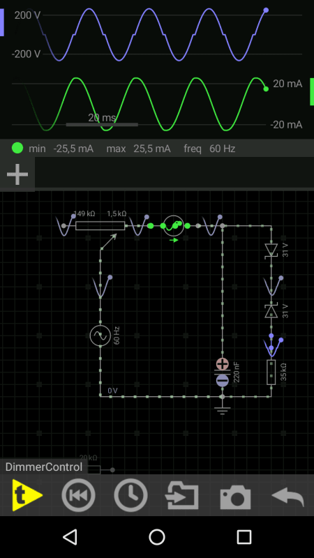

The following pictures are from a simulation. The result/values are very close to reality.
(Excelent and lightweight simulator, by the way: EveryCircuit)
This first picture here is the ideal: Works well from cutoff (not depicted) to span (as represented).
But you can see the current... Enough to fry the pot
This second one here is the voltage divider.
It cuts off well (500uV doesn't activate the triac), but it chops up the full wave (not depicted).
And... The current did not reduce much
Changing the fixed resistor or changing the capacitor messes with either cutoff or full wave (or both, if I stick a resistor in series with the pot).
I don't know what else to do.
If someone tells me it's impossible, I might believe
I'm unable to tell the supported power of the pot, but if knowing the size helps, it's one of those 3/4 of inch
OK. But don't quite get it. You are using Zeners instead of a Diac. Those two Components behave rather differently. So the simulation doesn't say what the real circit does.
Also, the peak voltage is just above 200 V. That would indicate an RMS value at about 155 V AC. That is a voltage that I have never seen, anywhere. If you have 220 V AC, then your peak voltage should be around 310 V.
A few sample Circuits below (just googled "dimmer circuit" and got hundreds of them). Note that there is always a current limiting series resistor to avoid overloading the potentiometer when at maximum. Without it, or a voltage divider connection, your pots won't live long.

I've been trying to explain the low peak voltage and found out that a series of factors lead to it, being the series resistor (even a small resistance reduces the voltage that much, depending on the arrangement), the capacitor (it has a resistance in AC, therefore producing a divider), and finally, the zeners (the point where this ~200 volts is being measured is AFTER them).

Your question about Zener vs Diac. No, they are not the same thing. A zener starts conducting at, say 30 - 35 V and then keeps that voltage until input gets below it. A Diac discharges like a flash when it gets above the break-down voltage, which usually is also 30-35 V, and transfers all of the energy in the "delay" capacitor to the Gate. Thus ensuring efficient turn-on. The zener Circuit is dependent on the available current (seldom more than milliamps) and will not gate the triac on.
That is also why you fry your potentiometers. If the triac does not turn on, you will have all voltage left to fry the potentiometer. When it turns on, the voltage drops to one or two V and that saves the potentiometer.
