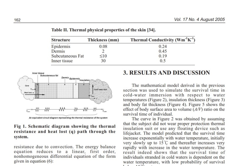

According to
"Modelling accidental hypothermia effects on a human body under different pathophysiological conditions"
The reference convective heat transfer coefficient between water and skin (h c o n,o u t ) is assumed to be equal to 0.100 W/(K c m 2) (corresponding to “treading water” condition)

The measurements of the thermal properties of biological tissue samples are based on a transient method. Thermal property measurements show that subcutaneous fat has the lowest thermal conductivity (0.23 W m(-1) K(-1)), while muscle gives the highest values (0.46 W m(-1) K(-1)).
However, that's not necessarily the issue. The question is what is the power output from the body given an internal physiological response to prevent hypothermia to the body.
BTW, the stack exchange cite results in a silly answer because equations cannot be arbitrarily used willy-nilly. The poster used a thin layer of skin as the heat transfer medium and got kW of transfer for their trouble, but as the responders point out, you don't have an infinite heat source behind that layer of skin, so the power value is only valid for about 20 seconds of exposure, which can be verified by calculating the total thermal mass of the volume (I used water at 27.5 C) of skin divided by the 8670 W. After that, the heat must come from the internal structures of the body, so if we assume muscle, then about 0.46 W/m-K thermal conductivity

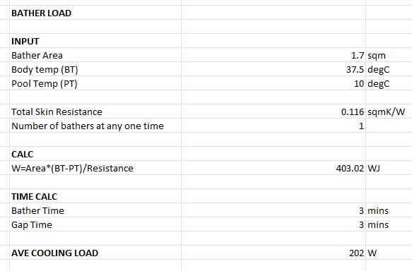

A ran the numbers using the total skin resistance and got the following results:
URL]
Works out to be less than the Mass method I posted earlier.
I need a calculation for different water temperatures so can't just use a single figure of say 350W.
The mass calc is more conservative @ 321W average whereas the R method comes in at 202W average.
I'm inclined to stay with the mass calc, what do you think? Time to move on to surface loads?
The body beneath the skin is neither an infinite heat source nor is it infinitely conductive. As I indicated earlier, the muscle tissue that would be under the skin has a thermal conductivity of 0.4 W/m-K
