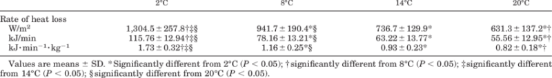

@Paul: You're answer seems to be here.
Overall-rate-of-heat-loss-during-whole-body-water-immersion-Water-Temperature-Conditions_zadzhn.png
@georgeverhese: BMR by definition applies while sedentary in air at 20ish degrees C. When immersed in cold water heat loss increases. A lot. In response the body tries to generate more heat to maintain temperature, and also tries to reduce heat loss by reducing blood flow to extremities, etc. If the body can't increase heat production and decrease heat loss by enough, then core temp starts to drop, until you die.
@mint,
So from this table, at 8degC (close enough to 10degC), for a 100kg person, we've got 116kJ/min heat loss into the cold water = 1930w, or roughly 2000w/person.
And at 20degC, closer to body temp at approx 30degC, it is still very high at 1640w/person, compared to the values from @paul and @IR. What gives here?
I can't quite work out the tables in that link but I think they weren't in the bath for very long.... Looks like less than a minute to me. Especially at 2C.
but then the recommendation is apparently 10-15 minutes max?
so maybe this is max cool down rate? So we are dealing with a transient thing here.

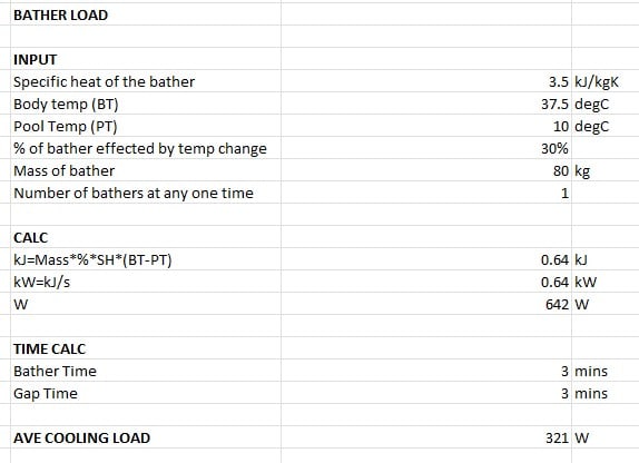

Hi Guys,
This is not going to be perfect, as expected, but I think is as good as I'm going to get re bather cooling loads.
It's based on mass as my previous post.
It assumes the bather is in for a short 3 mins and then gets out, heats back up and then gets back in after 3 mins. Typical of use.
URL]
This seems to correlate with my experience of using my own spa daily.
At 40degC water, the body would gain heat and not lose it. I would overheat at this temp and why spas should not be run at this temp.
At 35degC water, the heat lost is 58W which is close enough to how much a body needs to lose to keep it's temperature steady. I could stay in this water temp forever.
I feel cold in pools at 25degC unless I'm working out. This is why FINA controlled swimming events use this water temp. Heat loss shows at 292W.
Then at 10degC it shows as 642W which kind of seems high to me but, that's not a constant load on the water as they are only in the water for 50% of the time.
So, the load at 10degC on the water comes out at 321W which I think I'm comfortable with.
Unless anyone can see any glaring errors in this logic, then I'm done with this part of the post and the discussion has helped me heaps to clarify my thoughts.
