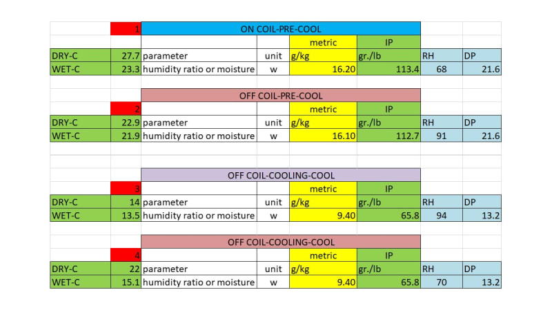

Why I concerned on performance of heat pipe that my builing’s FAHU, some FAHU are above 230 ton, in our buildings most of which equipped with heat pipe. The cooling coil are trapped with heat pipe and is very difficult to service the coil. The annual maintenance contractors were reluctant to service the unit because of the difficult to remove the heat pipe which rivetted around the coil and very congested between the walls. But all buildings are experiencing serious fresh air issues and humidity, so we decided to remove the heat pipes, some cut the pipe and some removed from the housing. Some FAHU was totally dismantled and took out the coil. It was totally blocked the coil. Now some local contractors proposed heat pipes of easy removal type and they submitted the data sheet. The manufacturer mainly claimed that the heat pipe will reduce the rows, in design, of cooling coil and will maintain relative humidity. So, I put in psychometric, I found very small changes in humidity content 0.1 g/kg only. this same digit is aligning with other manufactures also when comparing.
please look at the yeloow color column,

IRstuff: the above psychometric value was accounted from the selection sheet which manufacture provided me. it clearly shows 0.1g/kg moisture content removed by heat pipe. but relative humidity changed to 94% to 70%. apart these passive benefit(i have not conducted any field test to prove the performance)what the benefit of heat pipe especially is in FAHU operation.

It is clear from your table that heat pipe's primary function is to reheat the air not to dehumidify.Without the heat pipe you would have required a few hundred kw of electrical reheat to heat it from 14C to 22C.
However if this is an office or retail space I would question the need for the reheat as supplying air at 14C into the space will take a substantial burden off your cooling AHUs/FCUs or whaterver you are using to handle the room load
SAK9: you raised same thought what i was thinking that the reheat will be helpful if the application is 100% fresh air, but these FAHUS are supplied the air to terminal unit.then the fresh air mixing with return air from conditioned space and treated back to the room. the terminal unit's design is based to maintain comfort RH level at conditioned area.
