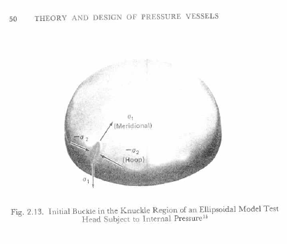

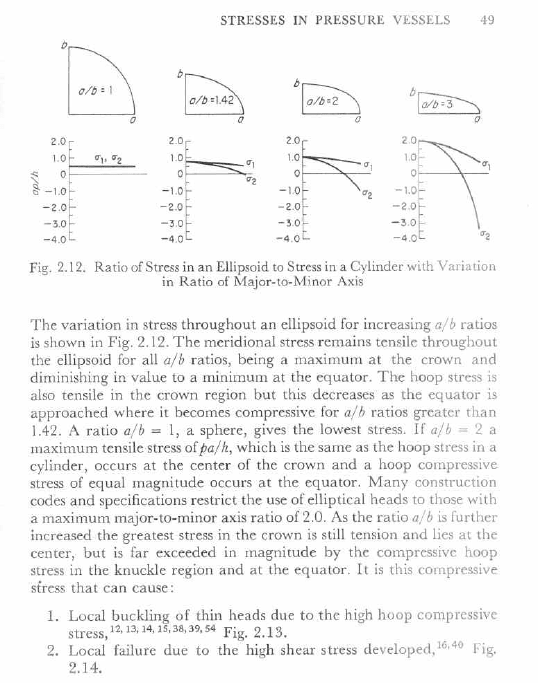

please refer below snap from theory and design of pressure vessels by John Harvey.
@Ariba01123
Thank you for sharing that reference.
Do you know the difference between sigma 1 and sigma 2 is in the photo?
Interesting that above 1.42 for a/b, the hoop stress becomes compressive near the knuckle and crown region (and above 2 the compressive is greater than the tensile stresses).
Hello Please refer below snap from theory and design of pressure vessels by John Harvey for sigma 1 and sigma 2.
