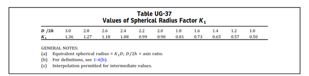

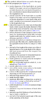

Folks, I am looking at 2021 ASME Sec. VIII, Div. 1, UG-32 for ellipsoidal heads. For the calculation of ellipsoidal head thickness, L states to look at Table UG-37 (image below).

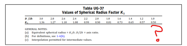

If I look at Table UG-37 (image below), it does not look like it says anything about L for ellipsoidal heads.
Can someone explain where I am supposed to find L for ellipsoidal heads, and also the relevance of Table UG-37 in the search for L?

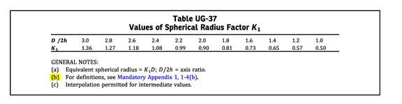

L is equivalent spherical inside radius for ellipsoidal heads which is K1D as per table UG 37, where the first row is D/2h. D and h are defined in Figure 1-4 of MA-1.
Even though the parameter L does not appear directly in calculations, the parameter t/L is used as a criterion for application of formulae and other requirements.
MA-1, 1-4(a)
The equations in (c) and (d) given below shall be used
for t/L ≥ 0.002. For t/L < 0.002, the rules of (f) shall also
be met
