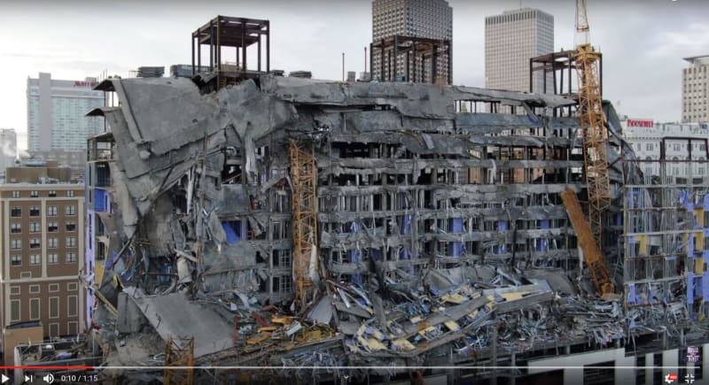

New drone image of the building.
We have found what may be the cause of the collapse!
I apologize in advance if this post seems disorganized, as it was cobbled together from a few different discussions.
Today I watched this video, "HARD ROCK COLLAPSE ULTIMATE LOAD PATH FAILURE 15TH..." Watch that video at about 30:40 to see the initiation of collapse in the area of the curved Rampart St side of the building. (I love this 'new' pool view of the start of failure that came out last week. I kept wondering when we would see security camera footage.) The rest of the video discusses the location of failure in non-technical language.

As a start, I checked one beam on the 15th Floor, the beam between BB & JJ at Col Row 10.2. The following is what I found.
(Note that it's possible that the beams in Col Row BB and JJ are worse than the beam from BB-JJ, but I didn't have time to check that yet.)
My findings and assumptions are:
(1) Did NOT analyze as composite concrete and steel beams, as MOJOJOHN says the studs are inadequate for composite action.
By the way, these beams are not composite steel beams. I checked a few and found that the studs were not
sufficient for composite action. They merely attach the slabs through the deck to the beams.
(2) I looked at the loading on the W16x26, loaded at approximately 10'-6" from Col Row JJ, with loads from Floors 16, 17, and Roof above via the column I will call "FF.1"
(3) At Floor 16 (and 17) in Col Row FF.1, the W10x19 carries the floor load of concrete and steel decking (assumed 45 psf and 53 psf, respectively, may be off by a few pounds) plus the design live load of 40 psf (no live load reduction). These beams frame into the Column FF.1. These beams carry almost 2000 lbs per foot from spans that are 27'-9 1/2" and 26'-2 7/8", for a total of 3862 lb/ft. Assumed that construction materials in place on October 12th are approximately equal to design loads, or that the floors would have eventually seen AT LEAST these design loads.
(4) The column FF.1 at Row 10.2 carries a total design load of 60.6 k from Floor 16, 60.6 k from Floor 17, and 52.1 k from the "Roof" for a total of 173.3k.
(5) With the 40 psf applied load on the 16th Floor & 17th Floor and 20 psf for the roof (I remember seeing a higher design load for at least parts of the roof, but I cannot find that information today; in any case, this was a part of the roof that was blocked off from guests' use), the W16x26 has the following Critical Stress Ratios:
Bending 1.342
Combined Bending 1.477
Shear 1.855
I haven't checked the bolts for this beam's connections yet.
This would indicate that the poor W16x26 will fail in shear, though as I mentioned above, the connection of the beam in Col Row BB at the Rampart St facade, also a W16x26, almost certainly failed first, as it carries load from TWO of these W16s.
Of course, we still have to say, "This was only the Permit Set. The For Construction drawings in use may have been revised", but I think the area identified is the initiation of failure for this building.
I can scan and send my sketches and notes for this analysis later. I suppose it's only fair to redo these calculations with the appropriate Live Load Reduction, but I don't have time to do that now.
What do you guys think?

As pointed out by dold (16 Oct 19 22:40), it appears the transfer beams are actually at level 16, not 15.
NOLAscience - I don't think you can assume the full 40 psf LL when looking at collapse, we don't know what actual load was on the beam but if it fails on the DL then that would be a strong indicator of the cause (maybe one of many).
Building on what you have in your post I looked back at the connections in the permit set. The permit sets notes delegated design except where designed in the drawing set. The drawing set shows all shear plate style (S3.14), I recall seeing some pictures showing a shear plate so I assume this was the style used.
Looking at S3.14 for W16x26 shows a 4 bolt (3/4" A325) with 1/2x4 plate and 3/16" weld. ASIC 14th page 10-110 for this configuration doesn't show a load for STD hole 1/2" plate but SSLT 41.5 kip but weld is 5/16" - drawing shows only 3/16" weld. 3/16" weld is only shown for 1/4" plate where connection capacity is 34.8 kip. So actual connection capacity is somewhere between 41.5 and 34.8 kip - ASSUMING actual connections followed permit set Typical.
If I take your 173.3 kip column load and multiply by 0.6 (rough estimate of DL only) that is 104 kip, assume 1/2 to each end of the W16 is 52 kips. Connection at best 41.5 - so connection failure. A connection failure also explains the sudden collapses. A beam overloaded would probably deflect a lot and then yielded instead of suddenly fracturing. Where a connection would tend to fail suddenly as bolts ripped out, weld broke or some other failure mode.

I gave up on running numbers based on the permit set of drawings since the photos show many differences between the drawings and actual construction.
The slabs seem to be thicker than the 5.5" shown on the drawings, and the transfer beams appear to be supporting one additional floor and the roof as opposed to two additional floors and the roof.
I do think the transfer beams/connections are the problem, but we probably can't run the actual numbers based on the information we have.

Due to the transfer framing being at the 16th Floor, not the 15th floor (but, note that the roof load I am using is quite low compared to the load from the added enclosed rooftop bar), revise the Total point load from 173.3k to 112.7 k (DL 84.0k), and reactions to Rleft = 47.7k, Rright = 65.0k.
I see the Shear Stress Ratio as 1.209 with V)allow = 54.0k. Again, that is with the Design Live Loads.
DL is 77% of the total load in my (original) 2 floor and roof loading; it is 74.5% for the (corrected) 1 floor and roof loading. Compare my DL only beam reaction of 48.4k to ldeem's calculated connection capacity of between 41.5 and 34.8k.
Remember, this isn't even the worst beam/girder AND we don't know if the beams were revised at the same time that the newer set of architectural drawings were released (May 2019). If I were sure these were the beams used, I would calculate the reactions for the worst beam/girder in Col Row BB. I think IceNine is correct, we have to get the FINAL For Construction set.
