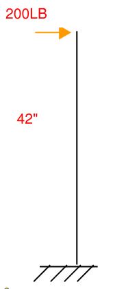

I have always used the 1.5 directional strength increase factor to calculate the moment capacity of my weld group from a guardrail post to it's baseplate.
For example, lets say the outside diameter of my pipe is 1.9" and I'm using a 3/16" weld all around.
Mu = 1.6*200LB*42" = 13.44 K-IN
Sx of weld group = pi * (D=1.9")^2 * (t=3/16") / 4 = 0.532 in3
LRFD Moment capacity of weld group = 1.5*22.27*0.532 = 17.8 K-IN (OKAY)

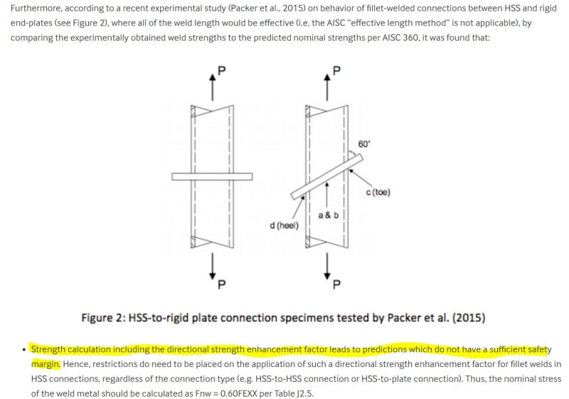

However, I came across this article that has me worried about using the 1.5 factor. I wanted to know if anyone else had heard of this.
It appears to have to do with the eccentricity of the fillet weld for one-sided welds on the sides of HSS tube walls
per the figure they provided:

So JAE, are you saying you agree and that the 1.5 factor should not be used in this application?
From the overall impression I get from the article, I would be reluctant to use it.
faq731-376
I might add that we rarely use it in most cases, even with a pure 90 deg. application on a plate.
Usually go to it only if we really need to.
