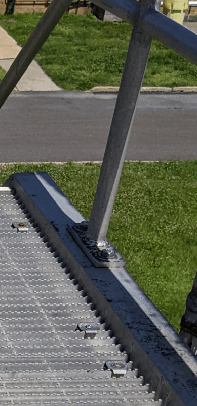

Is there a standard side mount bracket detail or product between a channel web and round post for an industrial guardrail? Each as-built I've seen has a mount on top flange of channel, acting as a pin connection, not meeting IBC lateral load criteria. Thank you
Why is it a pin? Granted, not a lot of room for a weld on a lot of them unless you go to an MC. But if there's room, you can weld all around and fix it. If you're worried about local deformation of the cross section neutering the fixity, add a web stiffener.
Otherwise, a plate or angle off the web and welded to the base of the post. But beware, this can extend your post several inches and some standard sizes may not work.
Pham - was specifically referring to the attached photo and observed other similar connections.
Ah. That one. It can still achieve fixity. You have to look at the couple formed by tension in the bolt and bearing between steel surfaces.

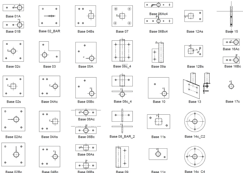

These are the different bases I encounter...

For the loads we are talking about that is effectively a rigid connection.
If you are more worried about deflection any lack of torsional restrain of beam/channel will lead to more deflection than that connection.

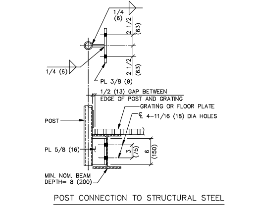

PIP (Process Industry Practices) publishes a document addressing different typical connections, it is PIP STF05520, Details for Pipe Railing for Walking and Working Surfaces.
This is from the 2003 version:
Rather than plate elements welded as shown, I also often see this done with a single angle (bolts on one side only).
