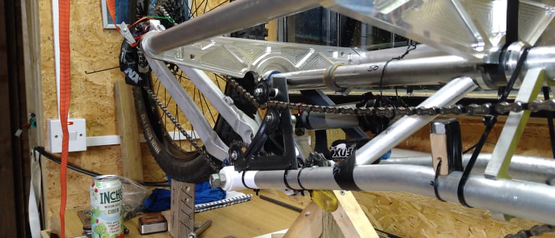

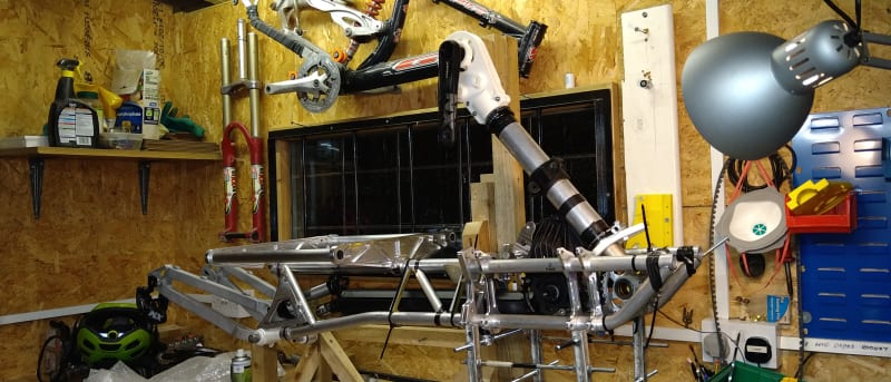

here are some pics of the mcck up , i said bike but really it is a trike if we are splitting hairs. i had a slight tumble bike racing and am now a paraplegic
