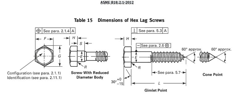

BTW... Your photo of rotted wood and a 'lag bolt threaded-end' visible. lexpatrie (Structural)13 May 24 16:47
Weird... the photo seems to show a bolt with H28 coarse threads and a relatively 'flat-tip'... typically fastened with a washer/nut... NOT the wood-lag-bolt with pointed-tip on the thread-ends and sharp-piercing widely spaced wood-screw threads I expected to see, thus...
