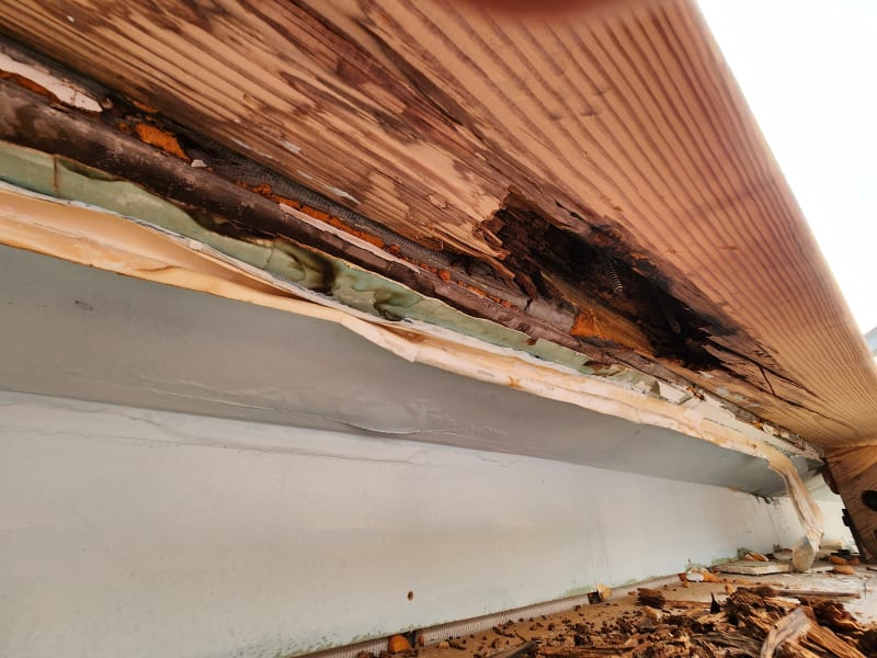

Hello friends and experts!
A water park facility that I do some consulting work for has some issues with rot in a few glulam beams. The building structure is glulam framing with a transparent panel roof. The beams in question are horizonal girt members located in the eave of the roof, ~16-ft above finish floor. It's a water park, so obviously serious humidity/moisture/chemical issues in general inside the facility. This particular area is located behind a large duct sock, there are no eave vents, and so very stagnant air/little to no air movement.
The roof panels are fastened to the glulam with stainless steel lag bolts, and the interesting thing is that the rot appears to have started internally at the lags. No signs of leaks from the roof, and just a few inches away from the rotted areas the moisture in the wood reads ~6%.
My best guess is the some form of condensation at the lags concentrating moisture in the wood? Recommendation is probably to replace in kind, but not sure on how to address the root cause of the issue.
Any thoughts on cause?

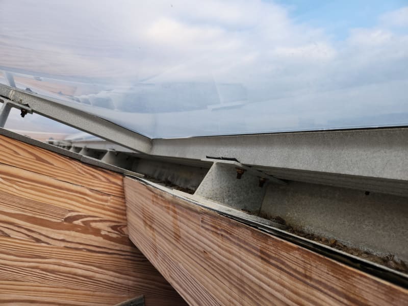

Here are the pictures in-line.
Is that water staining on the perimeter wood element indicative of condensation dripping onto it, and that's the source of the water? Would replacing the wood at the perimeter of the skylight and metal flashing with a drip edge do anything here to prevent a recurrence?

@lexpatrie, what you're seeing in the top picture is taking a picture of the roof system as high as I could get my phone. Translucent roof panels, supported on aluminum frame supported on glulam structure. The aluminum brackets/standoffs are fastened to the glulam with SS lags. The second picture is the underside of the horizontal glulam you see in the pic above, and it is rotted out around the SS lags.
It is likely galvanic rot. The fasteners reacting with the timber treatment, in the corrosive water park environment.
Probably condensation too, dripping water onto those locations.

Galvanic rot sure looks like what I'm seeing in the field, however these are UNTREATED glulam with stainless steel fasteners, either of which would seem to eliminate that process. These beams are located INSIDE/INDOORS, just under the translucent roof system, but in a water park so very hot, humid, harsh environment. Could have been/be roof leaks, not sure but not enough volume of water to be confirmed if so.
My guess:
1) Pool water evaporates, taking chlorine with it.
2) During winter months, the warm, wet, chlorinated air rises and contacts the framing and roofing.
3) The translucent roofing material is likely several degrees colder due to contact with outside air. Chlorinated condensate forms on the roof and, maybe on some roofing members that are cooler.
4) Chlorinated condensate drips/runs to connection points.
5) Stainless steel does not like chlorine. Many SS fasteners are made from 304, which doesn't handle it well. 316 can take about twice as much chlorine as 304 can, but can still be damaged by it. So the stainless fasteners in the wood are corroding and letting the water into the wood through the fastener holes.
What smell in a pool isn't chlorine, it is volatile chloramines that form when Cl reacts with various organics.
These chloramines will eat the SS (304 or 316), attack Al, and cause real issues with wood also.
These are very reactive compounds and are why ventilation of pool rooms to eliminate condensation is so crucial.
