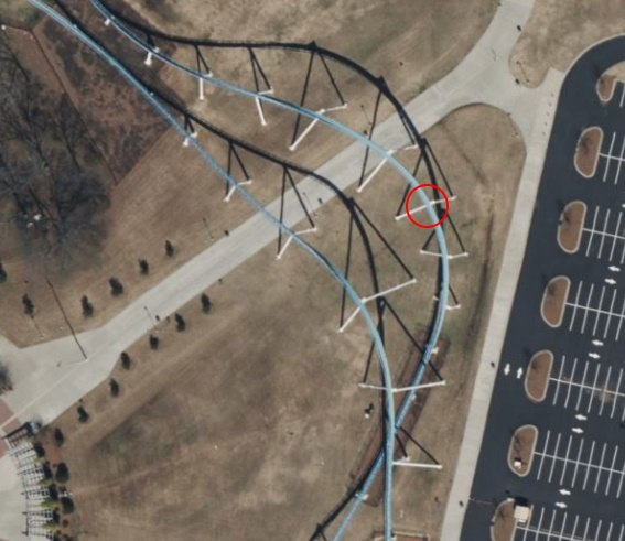

Some context. The crack is at the red circle, which is the apex of a high speed turn.
Given that <sarcasm> Carowinds' comprehensive safety protocols detected the crack and responded immediately to shut down the ride </sarcasm> an actual disaster was prevented.
Therefore it looks like Carowinds and Bolliger & Mabillard intend to move forward and treat this as a maintenance repair. As such, there will likely be no comprehensive independent investigation nor any public disclosure of what actually caused the failure.
So, it's up to us and the rest of the internet to speculate and analyze.
