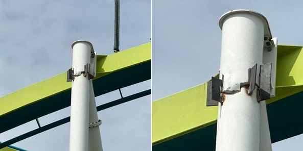

drwebb, its semantics to some degree, but in this case, based on a couple of photos or video screen shots shown above, the failure appears to have started as a crack at the weld and grown into a full section break.
It appears from the video that the cars are going up and then going down as they pass the support. That's going to create a lifting effect that reduces the contact pressure between the broken parts which allows them to slip sideways more easily. I wonder if looseness in the nearby bolted joint could have contributed to the failure.

This looks like someone overlooked a major load case or the load case wasn't including all the factors; probably that the uplift from the roller coaster car was determined but not the torque applied via the rails. Perhaps they overestimated the torsional resistance of the curved box beam? FEA wouldn't but hand calcs might.
It also looks like what I've come to call - the can opener. Where a stiff section ends in the side or face of a flexible element the stiff end acts to punch into the flexible element. There needs to be significant reinforcement to avoid the start of a fatigue crack.
It looks as though they have welded some (hopefully) temporary plates across the crack in the support column.

I wonder if the geometry is part of the problem. The inclined diagonal ties in just under the point of application of the load. That little piece of column above the diagonal workpoint is being asked to do quite a lot. It's not concentric, so it sees some flexure, but it's not a long enough cantilever above the workpoint to allow much in the way of "flexibility". I'm sure if we looked at the actual wall stresses in that little piece of pipe at the top there are some weird things going on there.
Tomfh, I'm guessing the bracing is to stabilize the structure so that the park around it can stay open to visitors.

I am curious about the areas I circled in red.
It's a joint. There is a fitting welded bolted to the rail, a fitting welded to the support, and splice plates joining those two fittings. What is circled is a chamfer on the corners of the fittings.
