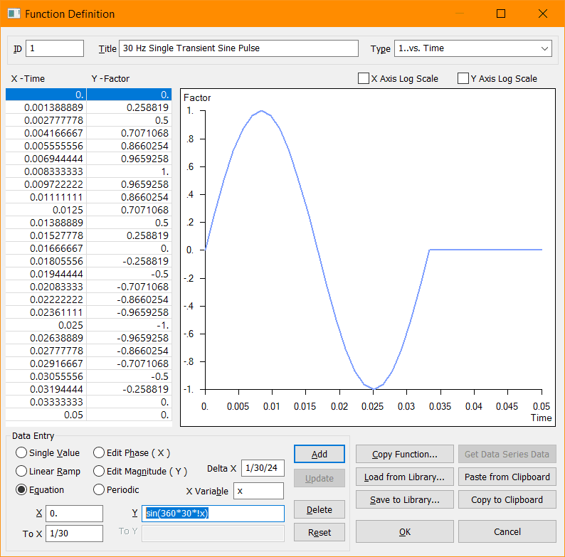

I am trying to analyze a forced excitation of a structure. The excitation node needs a 30Hz, 0-to-peak 0.050" input. From my understanding, this is a forced displacement problem. All I've been able to find is information on inputting acceleration. Does anyone have tips, guides, examples that I could follow? TIA

From your question I assume that you want to do this in time domain (time-history analysis). And since this is the Femap forum I assume that you use Nastran. The approach is probably valid for other solvers also, perhaps with some modification.
A few suggested steps:
On the node you want to excite, apply a constraint for the DOF you want to excite. This constraint should be in addition to your general constraints for the structure.
Next create a sinus function in time domain, basically a time dependent function with amplitude as function of time (vs Time). I suggest that you use 1.0 as peak amplitude.
Then create a displacement load on the node you want to excite for the DOF you want to excite. Use you required amplitude value for the displacement and make it dependent of the time function you just created.
Now you have a displacement with a time dependent amplitude function, and the constraint will ensure the the node is forced to move as requested.
So, now you use the constraint set and the load set to set up the Time-History Analysis.
I hope you can make it work now.
Good luck.
Thomas

In your case, you mention words 30 Hz & peak displacement: this means you need to apply to the base node a transient displacement to represent a 30 Hz single sine pulse defined in the time domain.
To learn how to define a sine function visit my blog here:
Basically:
• Use command MODEL > FUNCTION
• Select the Equation radio button and enter the following values (I like to use 24 points to define the sine pulse function):
Delta X = 1/30/24
X = 0 Y = sin(360*30*!x)
To X = 1/30
• Click the SINGLE VALUE button and enter the following values, this will expand the function till end time=0.05 s
X = 0.05 Y = 0
The resulting function curve will be the following:
Then when you apply the enforced displacement to the base node of the spider rigid RBE2 element prease associate the loading with this function and you are done!!.
Of course, the analysis type will be Modal Transient Response Dynamic Analysis (SEMTRAN SOL112), also know as Modal Time History Analysis.
