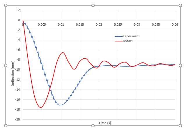

Dear all,
I am simulating the Impact of Timber Projectile on an Aluminum Panel.
The value of maximum deflection I get is quite close to experimental but the time is almost 10 times (See the pic attached).
How do you simulate this - do you use initial velocity applied to the projectile, gravity load or another approach ?
I assigned velocity to projectile
In Abaqus, I applied velocity to the projectile. In the Experiment, It was a drop weight test of Timber projectile, due to gravity

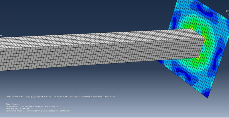

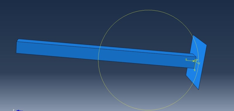

And you placed the projectile right above the target (initially in contact) ? Make sure that the value of the initial velocity is correct. Can you share some screenshots of the model and the results (possibly a few frames from the deformed shape contour plot) ?
I know the reason for difference in permanent deflection, Just wandering about the time of Impact
You need to consider the calculation of time required to complete the distance maintained between the timbre and panel. Distance/Initial velocity gives the time it will take to travel timbre to impact the panel. If you adjust the distance, the impact time will be exact.

Thank you very much for your response.
I am using velocity to the projectile and comparing from the point of impact. The difference of time period is almost 10 times.
So basically the whole impact and following effects such as rebound happen too fast in the analysis ? Double-check all the settings of the simulation including unit consistency. Something must be way off if there is such a difference.

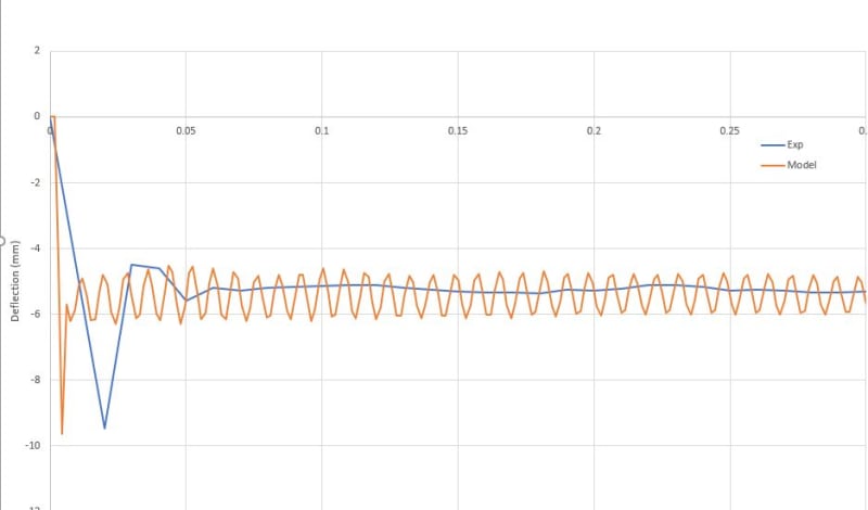

Can you share velocity vs time plot for both experiment and your simulation? That would make clear what is going wrong.
I repeated the test and also tried different boundary conditions.
This is the closest I could achieve.
