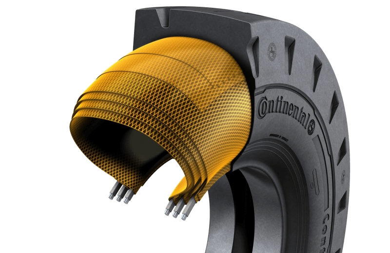

Consider rubber tire construction ..the filament arrangement with angle 50-55 degr. You may choose the angle within reasonable range , acc. to force distribution that you are looking for...
Just write ( car tire construction ) and search the web... one of the outcomes explaining the concept, ( four ply car tire )
Tires are made that way because it's an inexpensive way to get a structure that is strong 'enough' while providing the required level of compliance - not because it's the absolute strongest way to make a sheet good strong. The plies of a multi-ply tire are also not loaded in pure tension - they are constantly alternating between tension and compression as the tire rotates, and the stress state in the sidewall around the contact patch is, to say the least, complicated.

"Tires are made that way because it's an inexpensive way to get a structure that is strong 'enough' while providing the required level of compliance - not because it's the absolute strongest way to make a sheet good strong."
I have to disagree with that statement. Tires are made that way because it is the best possible way (or only way) to meet the requirements. There are very high tensile loads in tires due to air pressure, but they have to be flexible in every other way. Wire rope compared to steel bars is another example showing how structural design is used to alter strength vs flexibility of a material.
Solar sails have much in common with boat sails, which used to be made from panels of woven fabric sewn together with the fabric in each panel oriented for the load in that panel. The degree to which the fiber orientation could match the load direction was very limited, but still far superior to using a single sheet of fabric. Modern high performance sails use plastic films to support carbon tows that can be oriented perfectly with the loads. The plastic film catches the wind, the carbon fiber transfers the loads to the boat.
Tires have been made with embedded/overmolded/woven material - in various stages over time, literally since they were invented; I'd argue that it is very likely possible to R&D a tire design that is 'better' in some arbitrary tire performance metric, while using fundamentally different construction (i.e. something other than a couple of layers of woven material in the carcass) but no one does that because the current technology is just fine, and there's no motivation to spend 8 or 9 figures developing something new that might only be marginally better.
