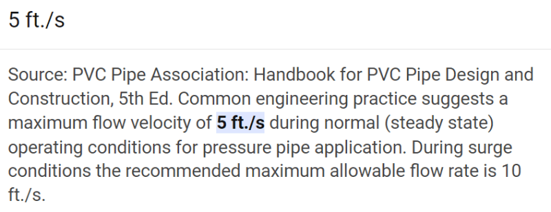

Question 1: Do I need a restriction in each branch of our plumbing?
According to a variety of sources, we should be limiting the velocity through our PVC pipes to 5 ft/sec.
5 ft/sec can be translated to GPM for each pipe size.
If I need to flow 3 GPM thru the branch to Tank A, I can pick a 1/2 IPS pipe and be below the 5 ft/sec … so far, so good.

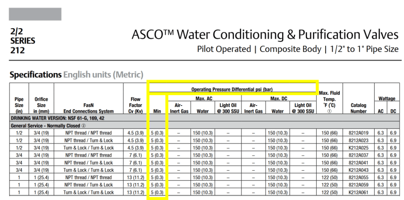

Question 2: How do I achieve a 5 psi pressure drop across a solenoid valve?
I’m looking at this ASCO valve.
According to its data sheet, it needs a minimum of 5 psi operating pressure differential.
Well, if I install a 1/2 IPS valve (Cv 4.5) in my 1/2 IPS pipe, I would need to pass 10 GPM through that valve in order to achieve that pressure drop.
If I only pass 3 GPM (5 ft/sec), the pressure drop across the valve is only 0.4 psi.
Question 2.1: What am I doing wrong?
Thanks for any help!

A number of sources say that 5 ft/sec should be the max velocity through PVC pipe.
It's not a big deal for me to size the piping for 5 ft/sec.
The "pilot operated" bit might be important if that is the motive force needed to pen the valve?[pre][/pre]
The 5 fps limiting velocity is based on water hammer or pressure surges due to rapid closure of a valve and sudden stopping of flow. Attached is the plastic pipe institute design manual chapter 6 and a pvc pipe manufacturer manual that discuss limiting velocity based on pressure surges.
The 5 psi differential for the valve appears to be because it is actually a diaphragm actuated pilot operated valve where the pilot valve is the solenoid which opens to allow pressure to be applied to the in-line diaphragm valve to open or close it and it needs a minimum of 5 psi.
Here is link to all PPI publications:
So the 5psi isn't a pressure drop, but is the minimum differential pressure when closed to allow it to open.
You might want to find a true solenoid valve where the valve opens and closes due to the action of the solenoid alone.

Your top table assumption of 5 ft/s is correct assuming a constant system pressure.
The pressure differential across the branch pipe is 20 psi. By conservation of energy and applying Bernoulli's equation,the exit velocity will increase because the static pressure had been converted to kinetic energy at atm. Pressure ( 0 psig).

Try this, instead of working forwards (header to tank), go backwards. First off, I am not sure why you think your solenoid valve needs to be line sized. Use the solenoid valve Cv, to not only set your flow rate but also your needed pressure-drop. Select a solenoid valve based on its Cv not the line size. So Cv=Q/(psid)^-2, your Q is 3 gpm from what I read and your psid is what you have as supply, minus friction losses. So you need to be looking for a solenoid valve with that Cv. This is how basic valve sizing is performed. For more reading, Emerson / Fisher has some great literature on valve sizing.
OP,
To add a little more, I made the assumption that you know what a Cv coefficient is. It is by definition the GPM of 60 deg F water the valve can pass at 1 psid. So if you are selecting a valve with a Cv of 4.5 and your desired flow rate is 3 GPM, then you are obviously starting in the wrong place unless you have a very low pressure system.
I will caution to say, this is not the correct method to size all valves and I will again point to the Emerson/Fisher literature for more guidance since there are other issues around choked flow, cavitation and such that need to be taken into consideration. I will say in spite of your best effort, you did arrive where you need to by realizing that to achieve your required flow rate that you needed to lose a certain amount of pressure because valves commonly act as not only "gates" to turn flow on and off but as restriction / flow control devices as well.
One more note of caution, I did not see anywhere in your post where you were addressing or even considering water hammer. Even at 20 psi in a PVC piping system this can occur depending on the dynamics of the system.
I am unclear why a valve would have inlet/outlet sizes that requires a reducer fitting at each end of the valve, thus increasing the overall length.
In my applications, space is often at a premium.
With the 1/2 ASCO valve in the OP example, I would need to flow 10 GPM to maintain a 5 psi pressure drop across the valve to ensure proper operation.
10 GPM in a 1/2" pipe is 15 fps.
Too fast.
5 fps is 3.4 GPM in a 1/2" pipe.
The required Cv for 3.4 GPM and a 5 psi drop is 1.34.
ASCO doesn't even offer one of these valves with a Cv that low. (the smallest is a 3/8 valve, Cv = 3)
If I go with the 3/8 valve, Cv = 3, and a 5 psi drop, that puts the GPM at 6.7 GPM
6.7 GPM and 5 fps indicates that the smallest pipe I can use with this valve is ... 3/4"?
Anything smaller would result in too high of a velocity.
Does that make sense? 3/8" valve, 3/4" pipe?
(Note: I've asked these questions of ASCO, and all I get are one sentence replies that don't answer the question)
Rodger,
Not sure if you missed it, but the issue is that your chosen valve type needs a a min pressure drop.
Try searching instead for "Direct Acting Solenoid valves"
Just an example but note in the description "(In order to open or close the valve it is not required to have any pressure difference between input and output)
Pilot operated valves are approx 1/2 the price of direct acting valves.
I need to make sure I fully understand the limitations of pilot operated valves before I advise our engineering group to avoid them.
One "problem" the direct acting valves seem to have in common is they are more sensitive to high velocity than pilot operated valves.
If the velocity is above 5 fps, they may not close properly, according to the manufacturers. 10 fps, definitely not.
I have found no such limitations in the pilot operated valve literature.
So, I would need some means to limit that velocity in each branch. Which means another device and additional cost on top of the x2 price of the valve.
Or, an extremely low upstream pressure.
My two choices appear to be ...
A. Pilot operated valve that requires a minimum GPM to operate properly, and piping much larger than the inlet/outlet of the valve to keep the pipe velocity below 5 fps.
B. Direct acting valve that requires a very low upstream pressure, or a flow restrictor, to limit the pipe velocity.
