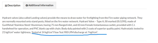

Hi all
I have a doubt on flow rates for fire hydrant landing valves. we have selected 100 mm X 80 mm Oblique type single head landing valves for our plant and we get 63mm orifice diameter but as per vendor specification it shows testing flow rate around 900 liters per minute at 7 bar pressure but for my understanding how can we get that much flow rate at 63mm nozzle and it is possible only if we consider 4.8 m/s velocity for the hydrant flow but i am bit confusing here at what will be the use of pressure here at 7 bar when we achieve this much flow rate ? or this pressure may be conserved at the discharge side in terms of 900 lpm ? can anyone please explain me in this.Screenshot (93).png

The flow rate and velocity is high, but not unreasonable for a hydrant. The 14 bar / 7 bar thing might be 14 bar working pressure at the hydrant and 7 bar at the end of the hose. (though without knowning how long the hose is that's not easy to state.

Without a sketch of what is confusing you, I am also a bit confused. There are two separate aspects to this calculation. The first is the system consisting of the fire water pump, the piping to the landing valve and the landing valve itself. It might well be that the piping is a ring main or a network and there are several valves that could be opened simultaneously, but to keep it simple and to illustrate the principles I will assume that you have a single pump feeding a single valve through a direct pipe.
You need to size the pump and piping so that at the desired flowrate of 900 l/min the pressure available at the outlet of the valve would be 7 kgf/cm2. If the line from the pump to the valve is 50 m of 4" Sch 40 pipe, the valve has a Cv of 150 and is mounted 5 m above the pump then the overall pressure drop would be just less than 1 kgf/cm2. If you provide a pump with a capacity of 900 l/min at 8 kgf/cm2 you will have 7 kgf/cm2 available for whatever is downstream of the landing valve. Remember that if you have more than 1 landing valve that could be open at the same time the total flowrate will be higher, but each valve will need 7 kgf/cm2 available at its outlet. It will be more complicated but the principle is the same.
The second aspect of the calculation is the equipment connected downstream of the landing valve. It is standard practice in the fire industry to specify the 7 kgf/cm2 that you have reported for the pressure available for this equipment, but in general this is a bit conservative. You don't want to be short of pressure when fighting a fire.
Typical downsteam equipment might consist of a 20 m long fire hose of 65 mm ID with a 25 mm nozzle. The pressure drop across this with a flowrate of 900 l/min would be about 6 kgf/m2, so the provision of 7 kgf/cm2 by the landing valve supplier is reasonable.
If these calculations do not eliminate your confusion you will need to provide us with a sketch and clear details of what is confusing you.
