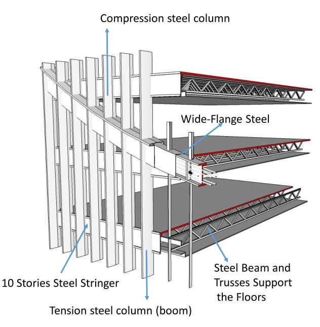

I think the cables are in line with the wide flange steel.
Check the pics and some explanations in this pdf
(MIStructE_IRE) That building is certainly a masterpiece koot. Wow! I’m assuming that the catenary (which looks like large steel sections) wouldn’t require any degree of post tensioning and is simply hanging there supporting all those floors? I wonder what the vibrations are like?
Without running any numbers, I'd guess the structure is very resistant to vibrations. A walker on one floor must excite much of the building to get floors moving, so the effective mass would be enormous.
