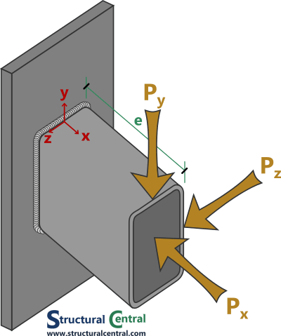

Good Day All,
I have a doubt regarding the computation of weld stresses using the directional method of Eurocode 3- Part 8. How we can distribute a vertical force as shown in the picture into shear stress and normal stresses? As I understand a portion of the forces will be carried by vertical weld as parallel stresses and other portion to horizontal weld which will eventually divided to shear components.
But could someone shed light on how to calculate it in proper way?
Thanks!

The reference which is based on the AISC code mainly mention two methods; Instantaneous Center of Rotation Method and Elastic Method. Considering the elastic method, for forces normal to the faying surface, the shear and tension forces can be summed vectorially to find the resultant shear stress and compare to the weld resistance as shown in the equation.
However, if we have force along the side ways direction also (say fz) which would be in the line parallel to the weld axis, can we vectorially sum that also?. Like this
If you also have a load in the z-direction (see below), you can sum the vectors using:
fmax = √((fx + fb)² + fy² + fz²)​
fx - axial stress from Px
fy - vertical shear stress from Py
fz - horizontal shear stress from Pz
fb - axial stress from Py*e and Pz*e

If there is a sideways force as shown in ProgrammingPE’s post then you have bending stress at ninety degrees Tao that in the y direction.
Hello Desertfox, I missed to show the sideway forces in the opening post. However, the question I have asked is mentioned by ProgrammingPE.
