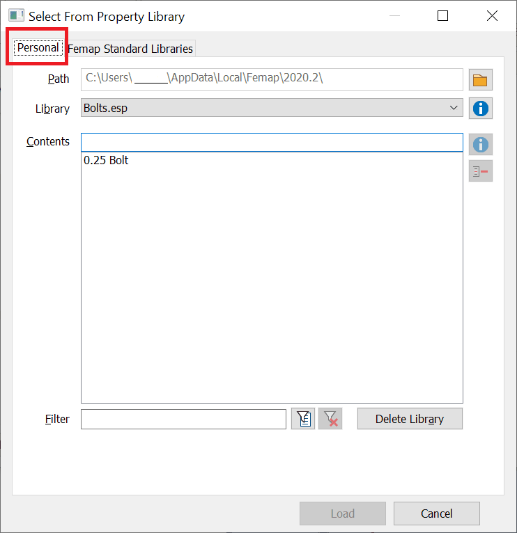

As an alternative to what you are doing, Femap has libraries for materials, properties and a couple others. These libraries can store saved properties that way you don't have to create them every time you start a new model. The Load and Save bottom toward the bottom of the property dialog box will bring you to the library dialog.
Here you can select a personal library that can be stored in any directory you would like. You can title the library whatever you would like. You can add to it as you need or modify what is existing in it.
