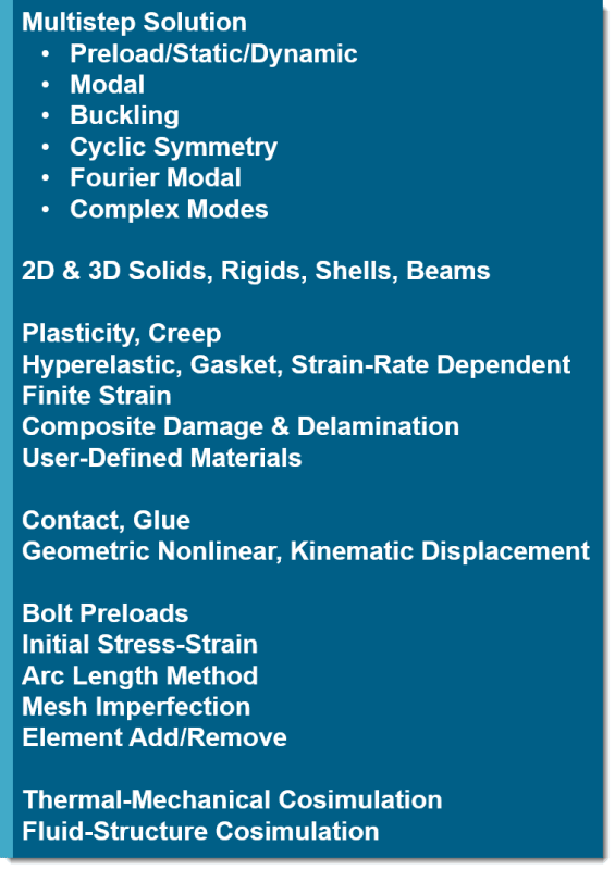

Dear Andrew,
Actually in FEMAP with Simcenter Nastran Nonlinear Multi-Step solver (SOL401/402) we don't have the possibility to perform an explicit nonlinear analysis, we only support transient implicit integration in time domain with large displacement effect, contact + friction, material nonlinearities:

Right, I figured out too that the current version apparently does not have an explicit sequence within. Thank you.
Andrew,
If you are limited to the current version of Femap and Nastran I would say that the explicit option is not there. But if you have access to an older version or if you can somehow access a stand-alone explicit solver than the door is open. Femap can support explicit solvers even if Simcenter Nastran currently don't have them.
Thomas
Thank you Thomas. That's what I have been thinking about too.
