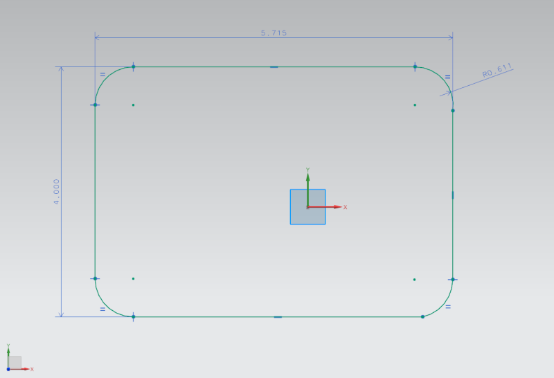

A sketch button just like "create rectangle" or "create polygon" that lets you "Create Rounded Rectangle"

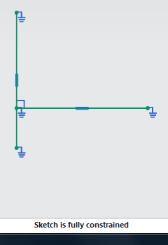

Also, I the perpendicular constraints and the parallel constraints are dysfunctional in the geometry solver.
They seem to be "soft" constraints" where horizontal, coincident, fixed and tangent seem to be "hard" constraints.
