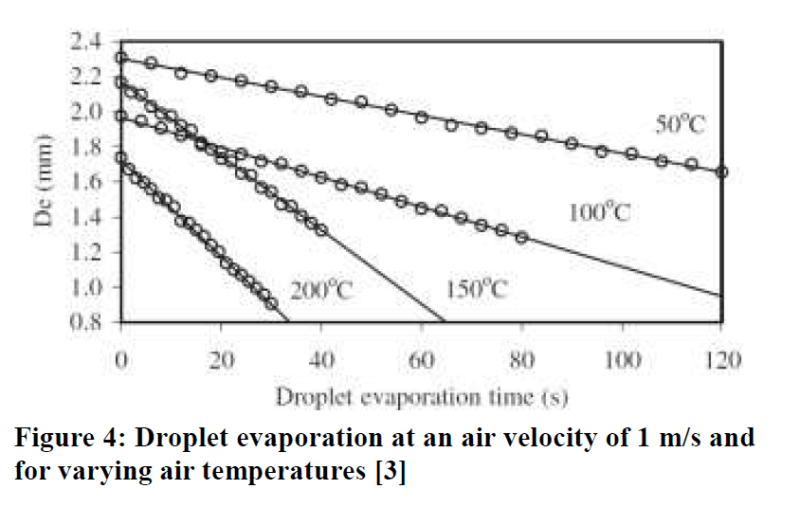

One of the links posted today by Eufalconimorph answers the question; evaporation time is proportional to droplet diameter, as would be expected

IRsttuff Not so fast. Since apparently mass can equal volume here at eng-tips and volume is PROPORTIONAL to diameter, why do you not suspect that perhaps the graph is showing diameter in error, when that should really be dependent on mass. If you agree that mass = volume, neither do you have any basis to citizens that opinion.

IR, that graph literally shows us that when "diameters are boiling", they get smaller at a linear rate much faster than when the diameters are not boiling, right?.

Maybe it's just me who's super tired and my brain not really working properly,[morning] but it seems strange to me that if Dc or is it De stands for diameter that a droplet at a diameter 1,75 mm should evaporate in 35 sekunds at +200 C.
I am not saying it's wrong, I am just a bit surprised.
Do you have a link. [ponder]

the paper link is I have to admit that I do not understand the minimal explanation given in the paper for figure 4, nor the reason it is opposite to other observations.
I read it differently too. But is it 35 or 0 seconds?
A droplet of D = 2mm at 100 C, evaporates in 0 seconds???
Start on the left with D = 1.5mm, go right to 100 C, go down to 58 seconds.
for D = 1mm, go right to 100 C, down to 120 s
Smaller drops take longer to evaporate.
RedSnake, its a Swedish study. Maybe some translation difficulty???
IRStuff is usually pretty good with heating, and most things really, so I'm sure he can tell us what's going on with that chart.
I can't even seem to interpret it correctly.

"It is interesting that, in opposite to papers [1] and [2], the droplet diameters were found to decrease linear with time in paper [3]. The droplet diameters over time for an air velocity of 1m/s and for varying temperatures are shown in Fig. 4."
Same drop. The diameter reduces linearly with time, not surface area, nor volume, nor mass.
Figure 2 [1], 3 [2] and 4 [3] isn't made in Sweden they are taken from 3 different other studies.
They have very different approaches and are a mix of calculations and actual experiments.
[1] Kinetics and evaporation of water drops in air, H.J. Holterman, IMAG report 2003-12, July 2003
[2] LABORATORY STUDIES OF WATER DROPLET EVAPORATION KINETICS, A.M. Moyle, P.M. Smidansky and D. Lamb, Department of Meteorology, The Pennsylvania State University, University Park, PA 16802
[3] The Evaporation of Water Droplets. A Single Droplet Drying Experiment, D.E. Walton, Drying Technology: An international journal, 22:3, pp. 431-456, 2004
