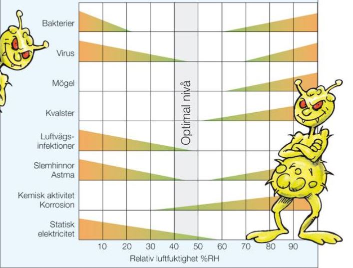

I had super problem at work after one day I was coughing the rest of the week and then it went away over the weekend.
The the safety engineer came by and made some measurements and came to the conclusion that the air was to dry 12-17 %RH and there where to much papper and to much dust.
So he sade buy a humidifier, easier said then done, I can buy almost every super technical thing I want at work but a simpel humidifier, was almost impossible I hade to order it from a subcontractor and then pay them.
Anyway the problem disappeared.
While waiting for it to arrive I tried to figur out what the optimal relativ humidity was and found this.
I decided to have it on 45% and it works.
This is also a reason why viruses spread more in the winter then in the summer here in the north, in combination with people being quite a lot inside and closer together.
Some viruses also protect themselves when it's cold buy pulling together(shrinking) and floats around much longer in the air.
When coming inside the body they go back to their normal size and do there dirty deeds.
