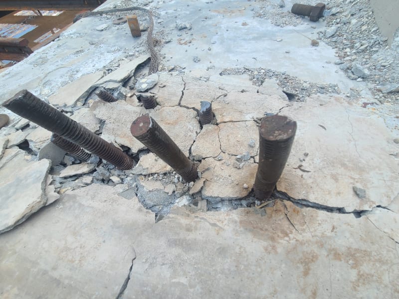

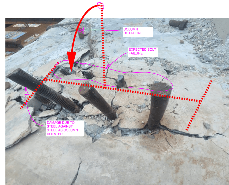

I'll do you one better. Had a building get partially blown down during erection during a straight line wind event. Everyone is safe. The column tipped over from the bottom of the photo to the top. Some anchors fractured as expected. Some striped. Some pulled out of the concrete partially and then stripped. One partially stripped. My best guess is that the stripped anchors are on the high side of the baseplate as the column fell and somehow that loaded them at an angle or also induced bending and somehow that caused those to strip. Really have no idea. Thoughts welcome.

When the column toppled were all the anchor bolts fully tightened, or were some, or all of them at some intermediate tensile loading?
The threads that stripped could that be from the side of the hole in column baseplate coming into contact with the anchor block as it fell over?
From the picture it appears all the anchor bolts failed across the section of the bolt.
Is that ever neat... I would have thought they would have 'torn' the anchor rods at the U/S of the nut. [ponder]
This is all very depressing. I always trusted the threads to yield the bolt.
That could be, Tom... I've always thought the threads would be intact and the threaded part would fail... It makes more sense for a ductile failure if the threads fail. Maybe failure mode was correct.
The damage to the threads could have been the reality of the rotation during the collapse? A picture of the mangled base plate would be interesting.

Brad805,
The column tipped the opposite way from what you show.
Desertfox,
It's very possible that some of the bolts weren't fully tightened. The building had yet to be racked square. I don't know if that's a standard erection procedure but several other anchor bolts in parts of the structure that didn't fall had some bolts not all the way down.
A question: Do you want the failure to occur by thread stripping (for ductility) or through the bolt itself (less ductile)? I've always thought that failure should occur through the tensile stress area... now I'm not so sure. Also, I would think that the nut threads would be slightly stronger than the bolt threads. [ponder]
I see I misread. Too early I guess. Was there a grout allowance for these base plates? If so, I would expect the columns would have been bearing on typical steel shim stacks. If that were the case I would expect the loading to the anchors would be very different than design during the collapse.
Hi all
dik in my opinion bolted joints should fail through the tensile region of the bolts and not through thread stripping; however if the all anchor bolts were not fully tightened down then that would mean the anchor bolts had different tensions just prior to failure. That would then mean that some of those bolts might well see tensions that far exceed what they were designed for and that might explain some of the thread stripping. Normally the female thread shear area is larger than the thread shear area of the anchor bolt so you are correct in saying that the female threads are stronger but the material grades of the nuts and bolts would need to be considered.
