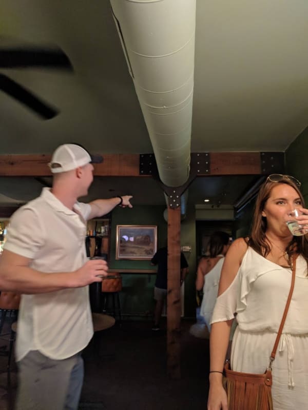

Speaking of unusual remodeling. I spotted this at a bar this weekend with some friends. Building was probably built in the 30's and is a 1 story builing. But the remodel was probably done in the last 4-5 years. Beam was not continuous over the top of the... air condition vent. Column didnt appear appear to go through the air condition either. That gusset plate was probably about 1/4'' thick too.

A couple of 1/4" gusset plates can hold quite a bit...you'd probably find those 4 strips of steel together have nearly the capacity of the post...
