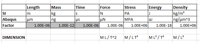

I somehow suspect, that the units are responsible. I use the following as my base units:
Length: µm
Mass: ng
Time: µs
Consequently, the other units that follow are:
Stress: MPa
Density: ng/µm³ (=kg/m³ divided by 1e06)
So the values that I have used:
Time: 1e06 (=1s)
Density: 0.00114 (=1140kg/m³)
Youngs Modulus: 1000 (=1GPa)
and the plastic values you can see above. I also attached the .inp file if anyone is interested.

If you run it in double precision, it may work. But I would be extremely careful with those exotic units. Make sure that they are all consistent.
Thank you for the quick answer :)
The thing is: I have to use µm as I ultimately want to analyze a representative Volume element for a fiber composite. So basically only the length is set.
Which consequent units would you use in that case? I am a complete novice so picked them in a way that none of the consequent units are too extreme.
I’ve never used such units but you have to pick base units first and then make sure that all the derived units are consistent with the base ones. In literature, you can find some examples of the usage of microscale units in Abaqus.
